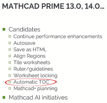

You may be interested to know that an automatically generated table of contents is being considered for Prime 13 or later.
It is not known whether this TOC will contain hyperlinks and could therefore also be also used for navigation.
If you are a paying customer with an active maintenance you may also consider to suggest an idea here or vote up an already existing idea. Not sure if it would help. though 😉
Frankly, Mathcad is being left behind by competitors. From the candidate feature list for Mathcad Prime 13, Maple Flow already has autosave, align regions and automatic toc (with hyperlinks). Units entry isn't as smooth, but they tell me they're working on Mathcad like entry of units

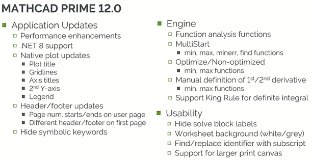

In return, the next version will offer the option to change the background color—oh no, not freely from a palette, we will only have the choice between white and gray. Wow!
We will have to wait to see how the promised improvements on the native 2D plots are actually implemented. From the announcement it looks like we are at least approaching old Mathcad now in this respect with version 12 of Prime. I guess the formatting abilities of the 2D plots still will not live up to the ones we had back in the good old days, though. We had much better control over the look, more different line widths and could set the size of the line and the dot/symbol independent from each other.
