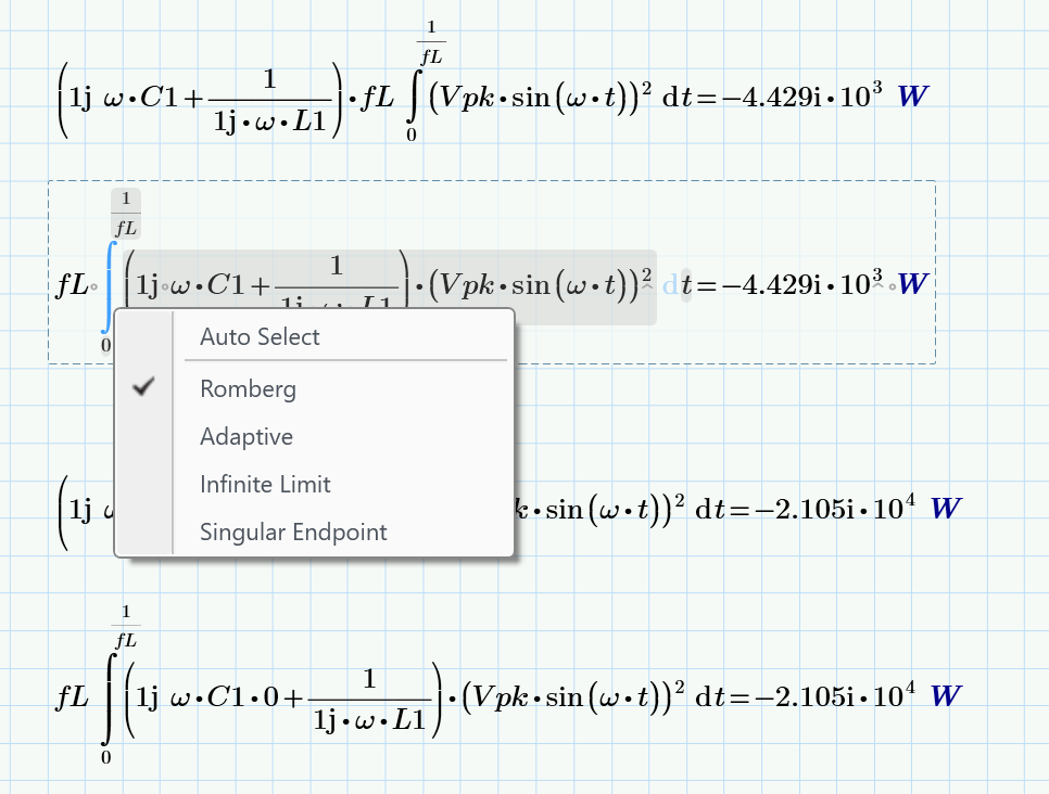

I have a question about why the integral values are different between the imaginary conductance is outside and inside the integral function.
or did I miss something on operators as calculating the imaginary term?

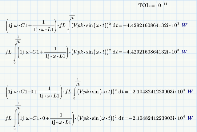

Numerical integration always is just an approximation. While integration would be summing up an infinite number of infinite small values, numerical integration basically sums up a larger number of rather small values. Taking into account rounding errors and the like, it does matter if the factor is only used once in front of the integral or if it is used in every summand.
Given that, it can be said that you get the more accurate results by placing the constant factors outside of the integral.
So the small differences you experienced are just numerical inaccuracies, a summation of round-off errors, etc.
It sometimes helps to set the system variable TOL to a lower value (default is 10^-3), but you may run into troubles (calculation not converging) if you set it too low.
10^-11 is too small in my opinion, but in case of your calculation it makes for equal results.
Setting TOL to 10^-12 lets the last integral fail.
So generally its better to make it easier to the numerics to get a more accurate result. In your case you may also place Vpk^2 in front of the integral.

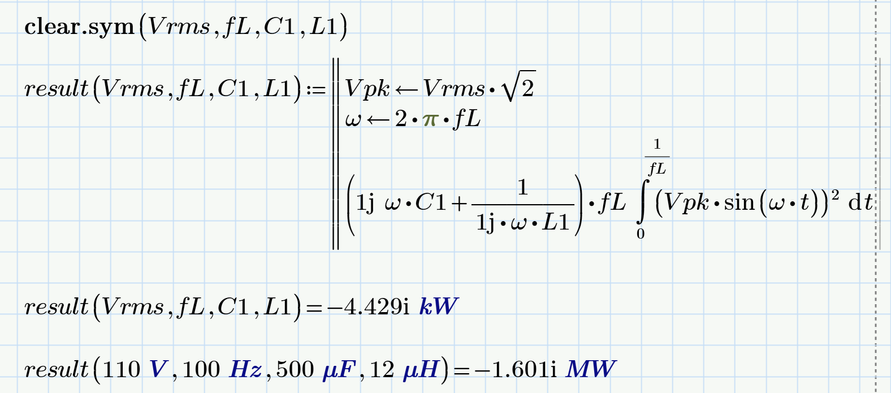

Another option may be using the symbolics.
Assign the result to a function in all input variables.
You may either do it before you define these variables or use clear.sym(...) to make them unknown to the symbolic engine.
This way may be especially useful if you intend to experiment with different sets of input values and want compare the results
Of course if you really intend to do so, it would make sense to make Vrms and only fL fcuntion arguments and calculate Vpeak and omega inside the function definition

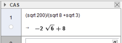

As far as I know, Xcas is also used by the free GeoGebra in its CAS view and its not even needed to tell it that it should simplify it
Ah, OK, I thought I'd seen mention that it was an Xcas-based system. If it's FriCAS then FriCAS should rationalize the denominator (at last for simple stuff) without asking (to -2 √2 √3 + 8 in my example), and there is a ratDenom function which does what it says.

Did you get an answer to your question? The choice of integrator is selectable from a right-click context menu.

I believe it's a new feature in Mathcad Prime 10. So, yes, you'll have to upgrade to MP10 to select the integrator type. You should be able to install MP10 alongside MP9, although the XMCD/XMCDZ/MCD converter will then only translate older worksheet formats to MP10.
