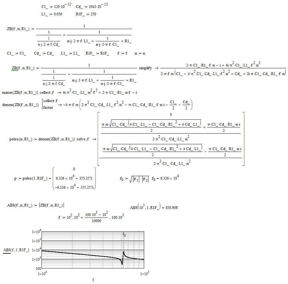

Hello Everyone
I use MATHCAD15.
If impedance is calculated with and without units,
it will be different numbers. I am confused.
Please give me advice.
I attached file.

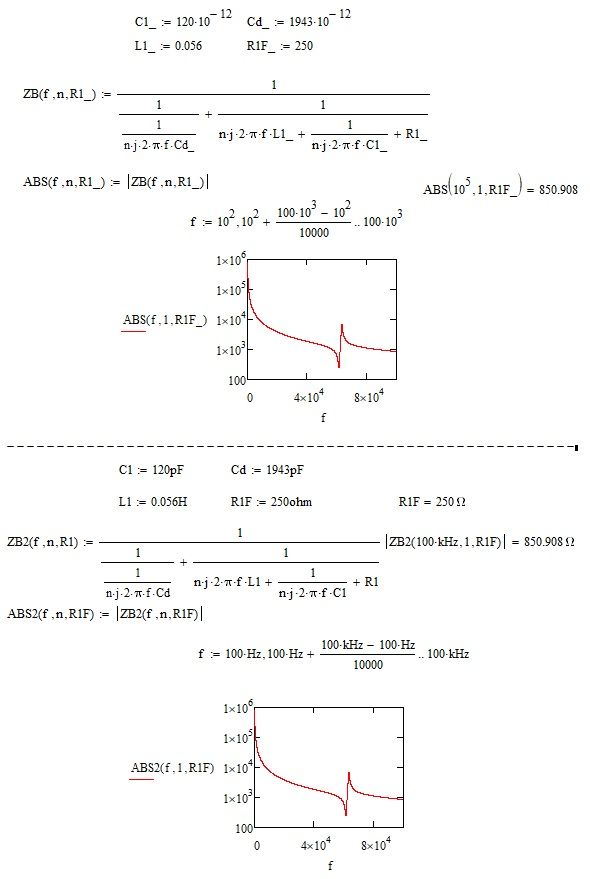

AlanStevens
(To:ssato)
In the first term in the denominator of the first function you have inadvertently put a decimal point in front of the 3 in the power of 10 that multiplies the frequency, f.(it is difficult to see!)
Alan

-MFra-
(To:ssato)
Hi Ssato,
Something extra:
ssato
(To:-MFra-)
Hello MFranc san
Thank you for your check.
AlanStevens
(To:ssato)
Alan
ssato
(To:AlanStevens)
Hello AlanStenvens san
Thank you for your responce.
I missed an important "point".
