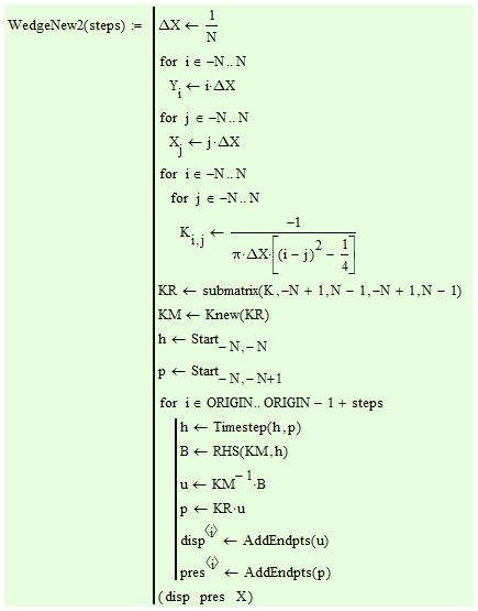

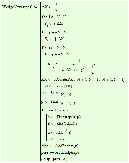

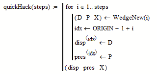

A quick hack would be to use my "WedgeNew" function in a loop and collect the results column-wise in a matrix:

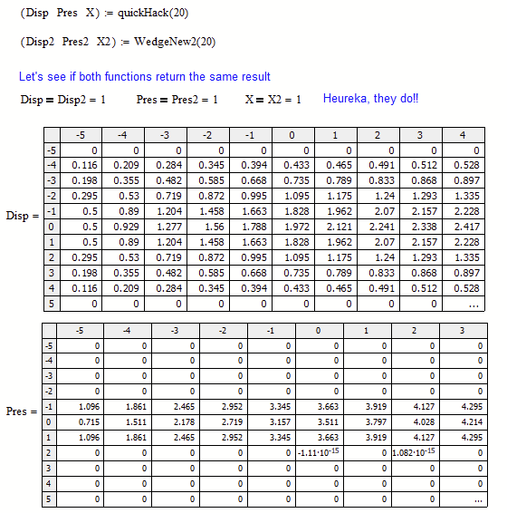

But its more efficient to rewrite the WedgeNew function to do the job right away:
So when you demand for 20 steps, the results of "disp" and "pres" would be a 11 x 20 matrix each.

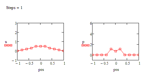

It looks to me that you are only interested in the results of the last iteration step, right?
So it would not be necessary to store all the intermediate results in a matrix.
Here is what I came up with - hope it helps.
Not sure if the animation makes much sense
Worksheet and avi attached
Hi Werner,
Thanks. The animation does make perfect sense! Although it was not clear from the worksheet I posted I do want to store the values from all the steps. When I get all done, I want to plot certain features of the calculation as a function of time. I wanted to store, e.g. the values of u in a matrix with each column being the results at an individual time step. This what I could not figure out how to index.
