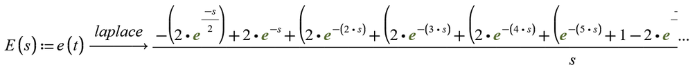

ttokoro
(To:ssato)
Using E(s) instead of 1/s*tanh(s*T/4), you can get the answer.  T and E must change the ones you use in your sheet.

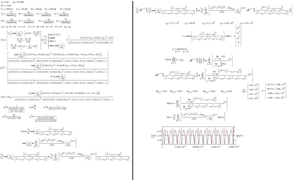

Hi!
my solution with Mathcad 15:

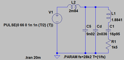

LucMeekes
(To:ssato)

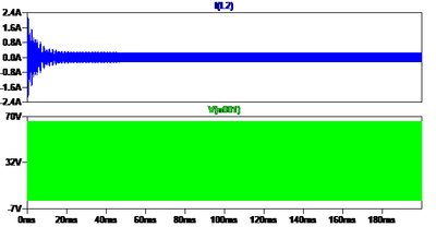

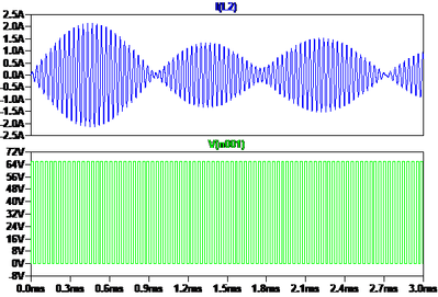

If I'm not mistaken, this your circuit:
(L1 is quite a large inductor)

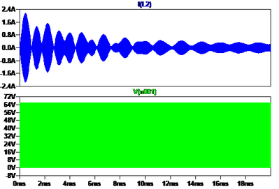

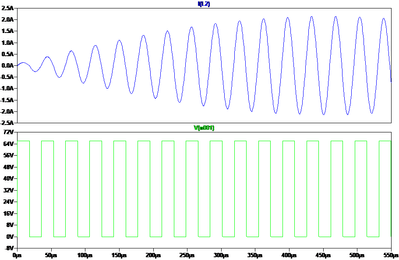

This is I1, the current in L2:
Appears to increase to a steady amplitude, but look further:
And in the long run, the first 20 ms:
And up to 200 ms.

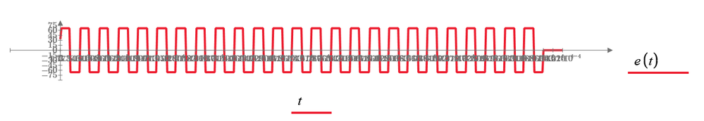

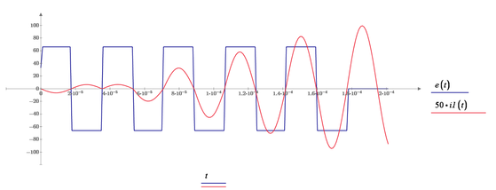

ttokoro
(To:LucMeekes)
Magnitude of i1(t) is different but the shape is almost same by Prime 7 for 25 cycles of applied voltage with +-both sign applied.

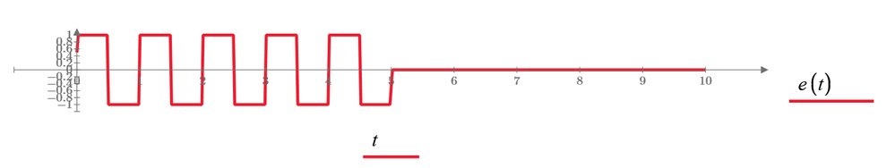

ssato
(To:ttokoro)
Hello Luc san, ttokoro san,
I attempt your method what is to describe my input wave form for just a few cycles of the square wave
I attached the work sheet. Almost is OK.
But I think the polarity of the only first cycle is reversed.
The polarity of waveform attached by ttokoro-san looks correct.
Is my wave form is correct , or do I have a mistake ?

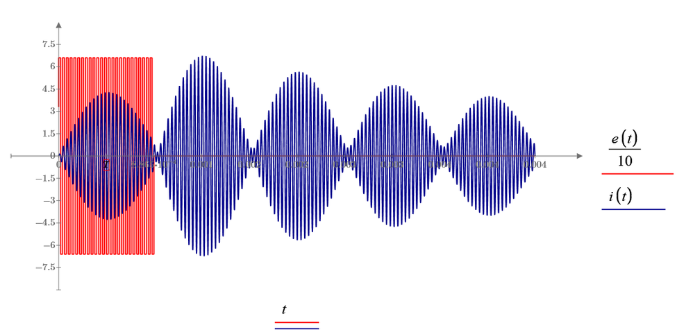

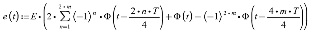

ttokoro
(To:ssato)
This is my Prime 7 answer of just 4 cycles. The value of each impedance has very small or large. So I without use float command and using all digits that Mathcad can.

ttokoro
(To:ttokoro)
Using unipolar voltage signal the result is as same as  by LucMeekes.

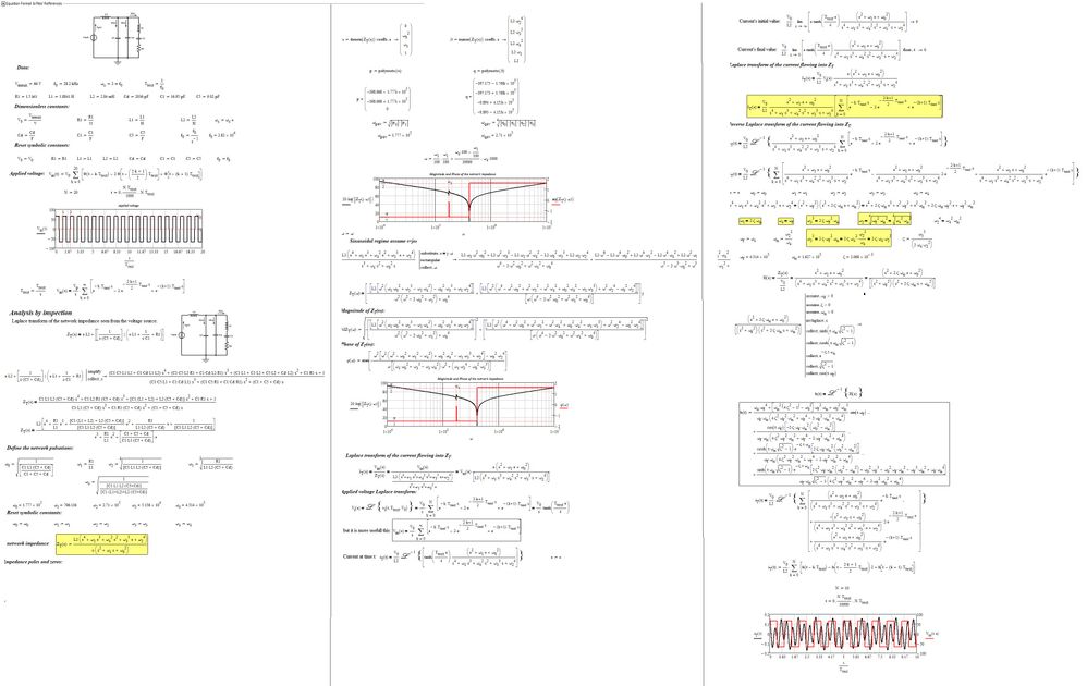

(To:ssato)
Hi!
Taking the cue from the circuit provided by LucMeekes and considering I1 as the current produced by the generator, I made this analysis of the circuit by inspection. The results are:

ttokoro
(To:-MFra-)
Dear MFra,
Your last equation h(t) has no Unit step function, USF
I think step voltage responce must have USF for every switchuing time as at first Luc shows us.
Because this transient responce is a convolution of Voltage signal and the inpulce response of the system.
-MFra-
(To:ttokoro)
thank you very much, I corrected the original.
