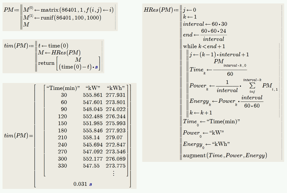

I guess your Powermatrix is a 86401 x 2 matrix. Thats not really big, indeed.
And you want to create a 49 x 3 matrix by averaging some values.
I retyped without doing any optimizations - just used a syntax to access matrix elements which I am more used to.
I even omitted the preallocation of the three vectors. Usually when dealing with big matrices thats a good idea but given that your three vectors are just 49 element vectors I guess the benefit will not be noticable.
As you can see in the screenshot it took about 30 ms to calculate your compressed matrix.
The calculation was done on a very old and lame notebook.
How long does it take youu to do the calculation? Or did I miss something?

I'm not entirely sure why yet, but your  HRes runs perfectly on my computer with my PowerMatrix.  So thank you very much!  I just started using Mathcad this week and was impressed with the software but that excessive calc time was starting to drive me insane.
I'm very curious though as to what specific subtle edit made such an exponential difference.
asw391
2-Explorer
(To:Werner_E)
My original program took 20 mins to run

I can't imagine that anything I changed is responsible for the significant difference in speed, though. Simply turned the calculation into a function (just gave it a try - even if I don't the result appears in a glance) and used the usual matrix indices M[i,j instead of M(i,j). There should be no difference in calc time doing so.
I also am curious as to what slowed down calculation on your side.

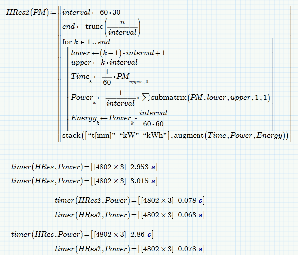

Your implimentation could take advantage of the submatrix command
b<-submatrix(PowerMatrix,(k-1}*interval+1,interval*k,1,1) to extract the respective rows into a column vector.
Power(k)<-you can then use Ctrl+4 to get the built in summation of a column vector b and divide by interval.
Both can be used in a program.
I haven't tried in this case, but from my experience I can tell the the submatrix command usually slows down calculations.  As the routine as it is calculates in a few Milliseconds I guess its not worth trying. It remains a mystery as to why it took 20 minutes for the OP in the first place but the cause seemed not to be due to the used methods to loop, sum up, etc.
(To:Werner_E)
OK, I was curious and gave it a try and you are right!
submatrix outperforms the sum operator even by a factor 40!!
I made the Powermatrix 100-times larger to get more reliable results:
