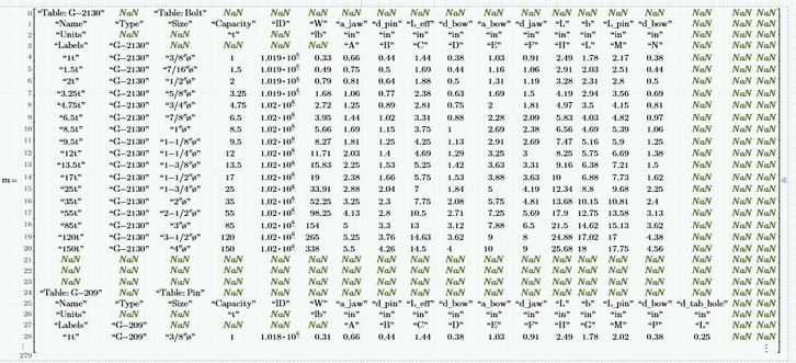

In my case I have a large 34x17 matrix that I want to enter into Prime so that you can see it is stand alone matrix.  I cannot link it to a file because I want to distribute it as a stand-alone calculation sheet.  It also has mixed data of strings, numbers and empty elements (NAN's).
Right now I use a keypress macro to 'type' the data into the Mathcad matrix.  It is still not superior to the computer industry standard of "cut and paste".

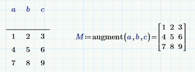

Copy from Excel to paste in Prime in a blank location results in a table, as Jeff explained. You can convert that table to a matrix by augmenting the table colums. This 'll work fine for a limited amount of table columns:
But for a large number of colums it's a bit tedious. There's another way.

@LucMeekes , That works except the READPRN didn't like my data tab delimited txt file whereas READEXCEL works on the original spreadsheet.  I have mixed numbers, strings and NaN's.  See attached txt file.
It will work for moderate sized matrices.  Only issue with a very large matrix is that I need to drag the lower limit down in order to show all the elements, otherwise Prime only copies the displayed elements.  My computer is reasonably fast but when I start getting past line 100 it starts to lag so much and it takes about 20min to finally see the whole matrix so that I can copy it.  So for a very large matrix like this it is still faster to use a keypress macro.
