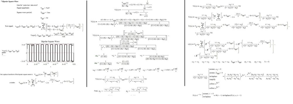

I'm trying to make a template that can be used for circuit analysing using Laplace transform.
Here, we have a second order RC lowpass filter and I want to use an repetitive input signal.
In V2(s) equation, where we have the input voltage I would like to use the f(s) input function or even better g(s) repetitive input function.
In the file attached you can see that I have 3 plots: one with input voltage as a constant, where it works and the plot is ok, and another two using f(s) and g(s), where it returns this error "Replace complex values and NaNs by real numbers".
What can be improved in order to use the repetitive s domain function?
Mathcad using is Prime 4 and you cand find attached a .pdf too.
Thanks.

Although realized with mathcad15, you can rewrite it in Prime. You should proceed in this way:
-MFra-
(To:-MFra-)
I enclose the Mathcad 15 worksheet related to your problem and which you can easily import into Prime. Learn the art and put it aside...

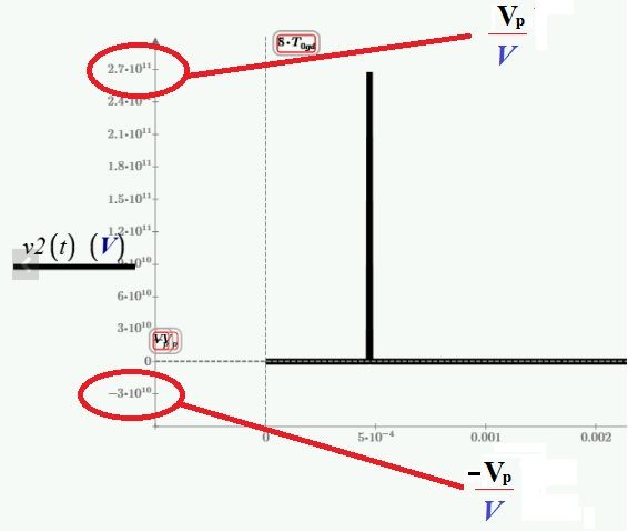

Hi -MF-,
If i rewrite your input signal, when I try to plot returns the following error: "This value must be a real number"

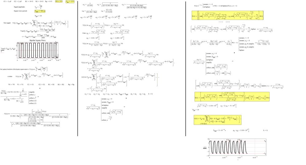

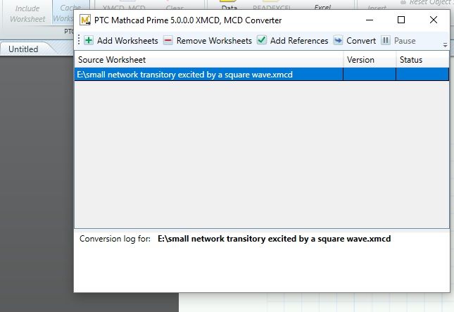

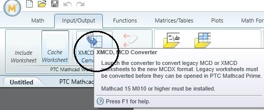

It is not necessary to rewrite the whole worksheet. It is sufficient and very fast (a few seconds) to import the file into Prime. Then you have to do some adaptation.
If you've already done it, did you import the file in Prime correctly?
(Vsqw is dimensionless while V.sqw isn't.)

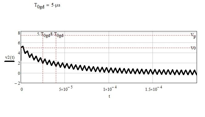

Hello again -MF-,
Sorry all for my slow reply.

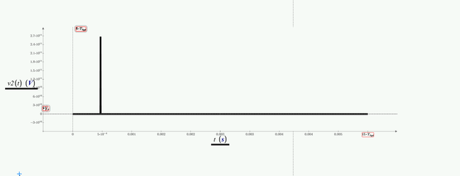

Yes I imported as you shown but it does't have the same result. See picture attached
2019-02-28 09_56_09-PTC Mathcad Prime 4.0 - C__#Giani_Work_Tools_Mathcad_Circuit analysis_small netw.png
Thank you.

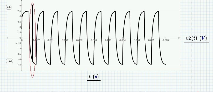

You have to check that the labels are the correct ones.

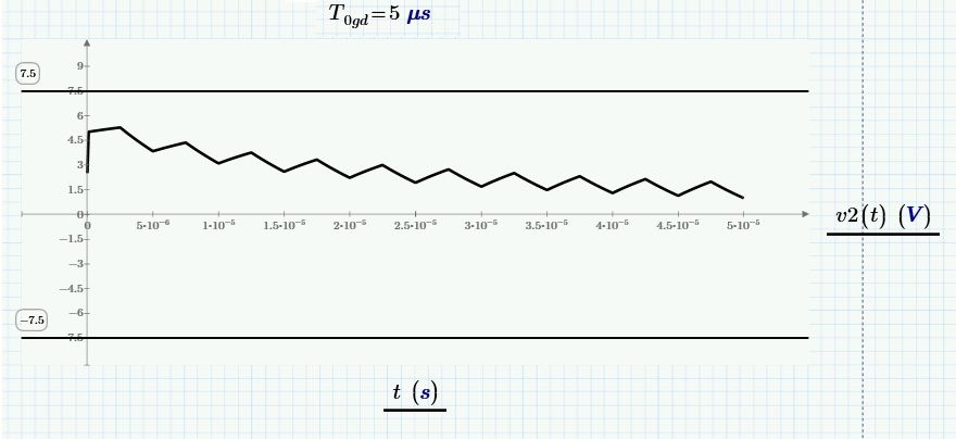

In any case, I attach the mcdx file.
In the graph there is a small anomaly (circled in red) to be corrected.

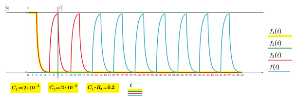

ttokoro
(To:ttokoro)
If C=2*10^-6 then tau is 10000 times faster than my result as already Werner_E wrote.
So the output signal shape is same to input waveform, 5(u(t)-u(t-2)).
My results change the C to 2*10^-2, therefore, transient change in output signal is visible. However, Prime 5 of my devise only solve one or two input series of inverse Laplace transformation. It can also solve numerically three input pulse series. Therefore, I made the 3rd response as a series of rest 7 pulse responses.
Because the 1st to 2nd responses after the 3rd response is too small to affect the results in my graph scales.
