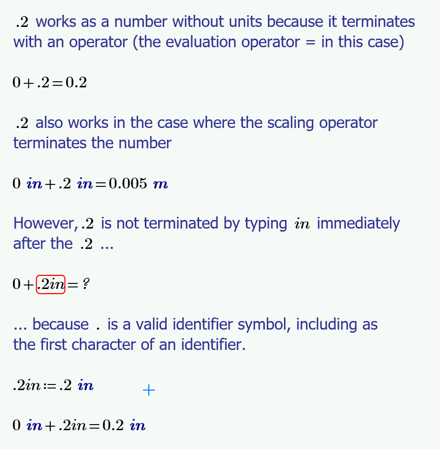

MathCAD Prime 7.0 is where my company is still stuck at, but it still has the very frustrating limitation/bug of not accepting decimal numbers without putting a leading zero before the decimal. It allows you to do this when calculating a number, but not when using units. Has this been fixed in subsequent versions?
It is frustrating not only from the standpoint that I never put leading zeros before a decimal, and never have, never do on any other program/software, and it's not a problem at any other time on any other software package I use (including MathCAD Prime 7.0) UNTIL I try to use units in the calculation. I have hundreds of worksheets where I have not used leading zeros and it used to calculate everything just fine, even with the use of units.
The reason you can't type ".2in" is because the dot is a valid leading character in an identifier name.
When the number begins with 0, Mathcad Prime recognises a non-numerical character as the number string terminator (unless that character is an i or a j, in which case Mathcad interprets the number as imaginary).

Maybe type an * (explicit multiplication) between the 2 and the i...
I can confirm that this behaviour has not changed in Prime 10.
As a workaround you may type an explicit multiplication (*) between the number and the unit as suggested by Luc or (for consistency) an implicit one which you get by pressing ctrl-shift-U.
BTW, Prime calls this implicit multiplication the "scaling operator".

A little more digging shows that the ISO 80000-1:2022 states:
If the magnitude (absolute value) of the numbers is less than 1, the decimal sign shall be preceded by a zero."
Earlier versions, including the British Standard 31, have similar wording, although the “shall” is replaced by “should” in some cases.
So, Mathcad’s behaviour in this respect would appear to be formally neither a limitation nor a bug but rather correct, irrespective of common practice.
