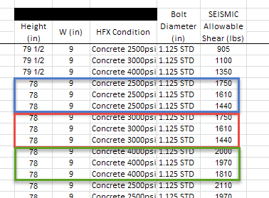

Your list includes a lot of duplicates concerbning the first four columns and the bolt diameter it "1.125 STD" throughout.
So which result do you expects with Height=78, Width=9, HFX Cond = Concrete 2500psi and bolt d. =1.125 ?
Hi @Werner_E,
You are right, I forgot to add one more column. Plese see revised file. The table is much more complex but I was trying to simplify it. The idea is that no row repeats in a table of 1000+ rows.

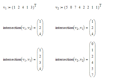

(To:Werner_E)
If my first guess wa right, you may be looking for something like this
I don't investigate why your modified routine is not doing this as the routine was designed by Richard to do soemthing completely different one.
BTW you can use "intersect" also for sorting a vector and removing duplicate values if you provide the same vector twice as argument.

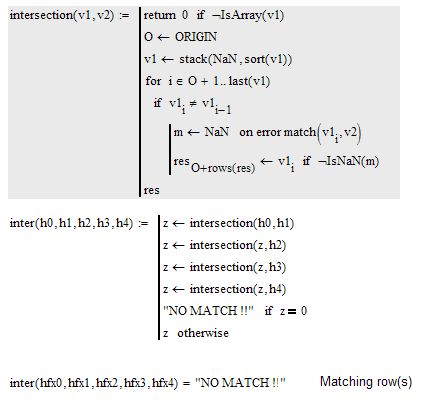

(To:Werner_E)
Addendum:
The function "intersection" returns the number 0 and not a vector, if no common value is found.
This can be a problem if you nest that function to find the intersection of more than two vectors
To cope with this, add one line of code on top:
This should cure that problem
