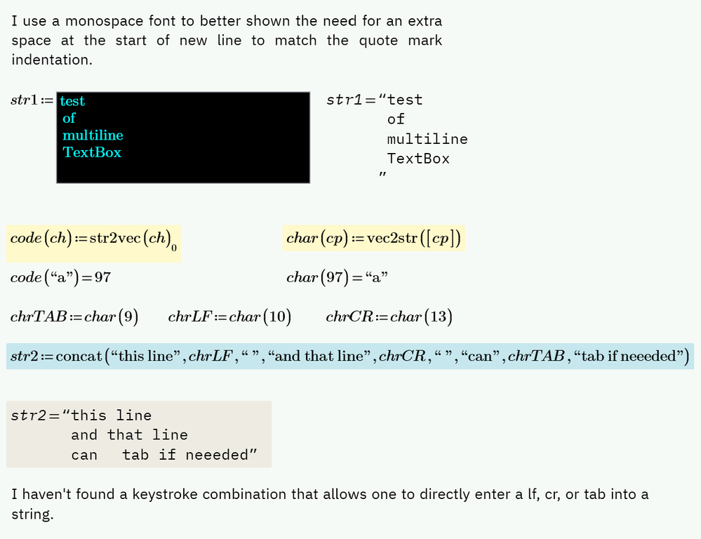

Yes, I already do that, thanks.  However, LF didn't consistently appear in a string returned from a control.
Interestingly, LF, CR, and TAB work as you might expect hope when viewing Mathcad strings.
