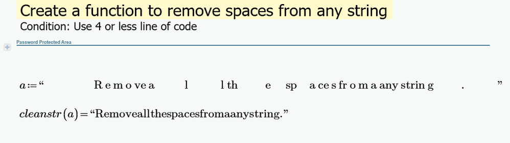

MathCAD Prime string challenge
Perez
LucMeekes
(To:Perez)

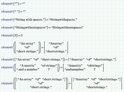

Ah, you want the function to just return the value if it's non-string. That can be done,
Being a version that runs in express, it is necessarily a oneliner.
I've enhanced it to allow arrays (vectors, and even nested, matrices), and it now requires no second parameter.
With so many oneline solutions, I propose you add another property to the table: runs in express.

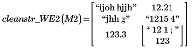

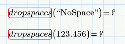

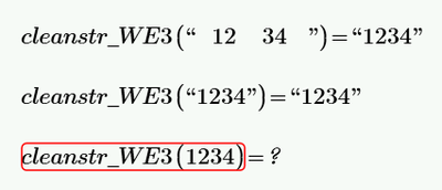

How about a 1-liner ?
But, as you can see in the sheet attached, my 1-liner suffers from the same problem as your function - it fails if the string does not contain any spaces.
That's a bug which can easily be fixed by using a "try...on error..." statement, But now the new function is four lines high 😞
EDIT: OK, the third attempt "cleanstr_WE3( )" now is a 1-liner again even though it deals correctly with strings containing no spaces.
This last function still has a drawback (that the second version "cleanstr_WE2( )" does NOT suffer from) and can fail, but I leave that as a challenge for you to find out when and why 😉
As nobody else has answered so far, I simply attached the new file (format P9) containing all three of my attempts in a collapsed and password protected area with a time stamp.

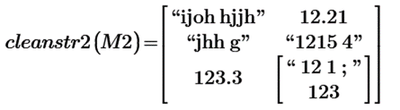

Perez
(To:Werner_E)
If "cleanstr_WE3( )" is a 1-liner, then it is working great except when the string is not a string. I think inside a "try..on" statement will become a 4-liner.
I have corrected the original version but now it became a 10-liner:
Note: Attached prime 9 worksheet (still password protected until the challenge has a winner. Potential winner: Werner_E )

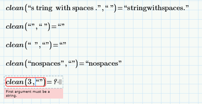

Mine is a one-liner, with the requirement that it (necessarily) takes two arguments, the second argument is a string (any string). But it runs in Prime express.
It has the following behaviour:
I cannot hide it in a password protected collapsed area, so will not disclose it yet.
What I do know is that you can build it into a two-liner for full-Prime, where it then requires only one parameter, the string itself.
I'll bite.
One liner in Prime full version.
Utilizes a trim function that is only availanble in full Prime
Uses a truth table to sort the vector of ASCII codes.
Not interested in password protecting it.
Cheers
Terry
Similar to my first attempt with similar flaws 😉
BTW, you may simply use  match(32,str2vec(a))  to get the index list for the trim command.

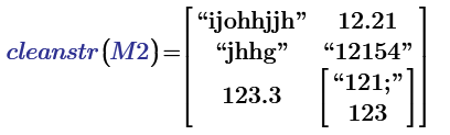

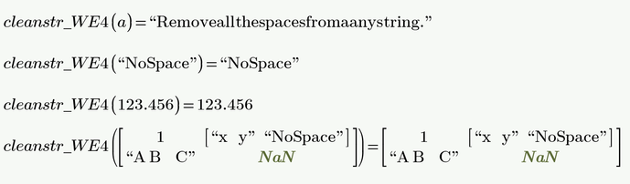

(To:Perez)
OK, here is a 1-liner which also deals with non-string arguments.
The next step would then be a function that handles the input recursively and removes the spaces in all the strings it contains, but leaves the nested structure intact, so that the result in the last example would look like this:
BTW, this fourth attempt still suffers from the same little flaw as the third one.
The most stable so far is the second one which also correctly dealt with non-strings, but because of the used "try ... on error" takes up four lines.

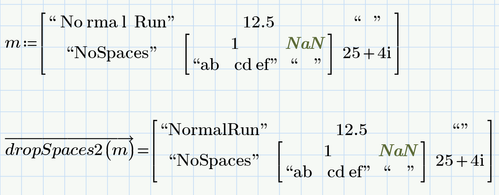

herewith is one liner with testing.  dropSpaces2(a)
Can handle data besides strings
Can handle string with no spaces,
Can handle string of any number of spaces only,
Can be applied element by element to a matrix.

I would replace "Only Spaces" by an empty string ""
Quite well done, indeed, even though its not working recursively 😉
My functions will deal with matrices (also not recursively for nested ones) if called vectorized.
But I just noticed that none of my functions would deal correctly with a string containing all spaces. They either throw an error or return that string unchanged 😞
When I tried to fix this (and still stay with a one liner) I came up with something which was very (too) similar to your function.

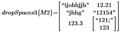

So I abandoned it and instead I modified your dropSpaces2 so that it now will recursively deal with nested matrices (no vectorization necessary when you call the function) and also streamlined it a little bit (str2vec(a) is now only calculated once and assigned a local variable).
I also fixed a bug in your function as it threw an error if the parameter was the empty string ("").
