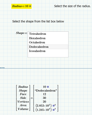

  • Create a calculator where the user can select a regular polyhedron by its name or number of sides, and for a given radius of the circumscribed circle of the polygonal face, the surface area (optional: and volume) will be calculated.
  • You can use a Combo Box input control for selecting the polyhedron. The ambitious can use one of the advanced input controls available in Mathcad Prime 10 (just released April 10th).
  • After the user selects a polyhedron, the number of vertices, number of edges, and Euler characteristic for the polyhedron should be displayed on the worksheet. (Hint: you can’t calculate the number of vertices or edges, so you will have to store them in a Combo box, matrix, or table.)

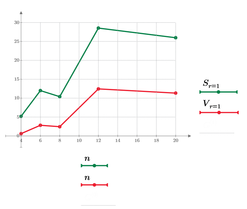

  • (Optional) Using the Chart Component, graph the surface area (optional: and volume) as a function of the number of faces. (Hint: add a 2nd Y-axis if including volume.) Assume a radius of 100.

Prime 10 with plots. Tokoro.
ttokoro
(To:ttokoro)
Add r=1 plot.

My first Prime 10 Document. No plots!
No specific units used for the Length.
Here's my function heavy attempt.
