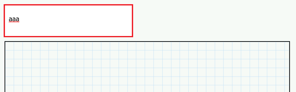

You can put picture into Header, as shown in following picture.
I guess requested functionality is not implemented. To be sure, please ask PTC Support.

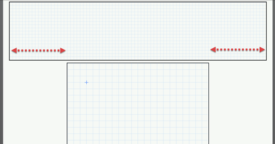

You are talking about this
I, too, could not find an option to fix this.
I would call it a bug or sloppiness in software development that this was not thought of.
It is also very strange and inappropriate that the grid size in the header apparently cannot be changed.
The corresponding button only changes the grid in the main area.
You may consider reporting the issue to PTC support.
