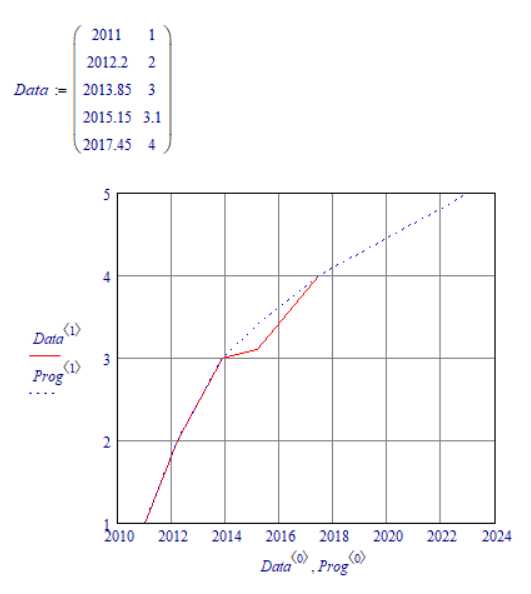

The steadily increasing time between releases (up to 4.0) suggests that the "early 2018" estimate for Prime 5.0 is management wishful thinking.

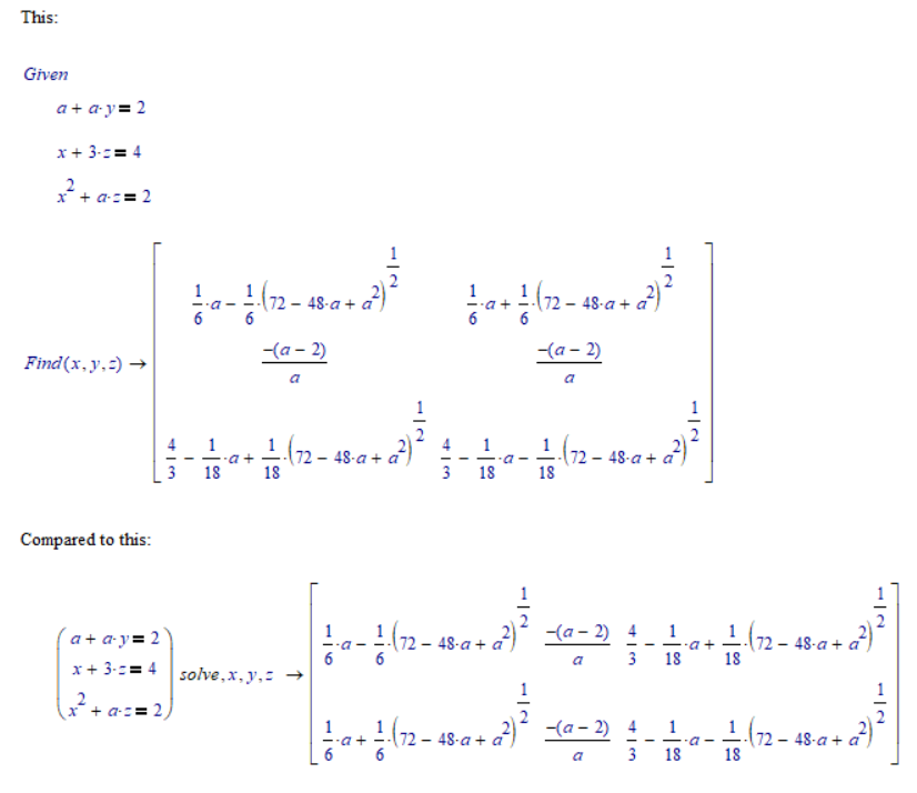

I don't think that all the symbolic functionality that we have in mathcad 15 are supported in Prime 4.0:
When I converted some of my files, I encountered a few messages telling me that my symbolic operation was not supported : for example:
Given
x + a*y = 2
x+3*z = 4
x^2 +a*z =2
Find (x,y,z) ->
Gives 3 pairs of responses that are functions of the parameter a , when using mathcad 15
but with Prime 4.0 I get no response and the following message instead : "The symbolic evaluation of solving functions is not supported in the current version of PTC Mathcad" . And this is with Prime 4.0 loaded a few days ago from scratch on a new computer... But I must say that otherwise you are correct, most of the symbolic operations are supported and with exactly the same format as with Mathcad 15, which tells me that they are using the same symbolic processor core. But for some odd reason you cannot solve a system of 'symbolic' equations, which is a big miss in my opinion... When in the past colleagues who were using matlab for which they didn't have the symbolic toolbox, were coming to me for help with Mathcad, most of the time it was to solve a system of symbolic equations...

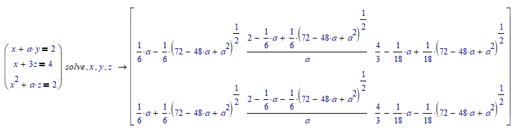

You still can solve systems of equations symbolically, but you can't use a solve block to do so. You will have to put all equations in a vector and use the symbolic solve command. And yes, in Mathcad this symbolic solve sometimes behaved differently compared to an equivalent solve block evaluated symbolically.

Can you do the lower one in Prime?

Prime 3.0:

Probably, since you seem to be able to do it...
But frankly, I would first have to find out how to edit what you did, and when I face the menu of Prime 4.0 I don't even know where to start as I find the new menus not intuitive at all... And if I need to spend more than 5 seconds trying to find the symbolic menu, that is not a good start... And besides I have 30 years worth of mathcad files, and after trying to convert one of them that would be typical of the complexity of my files, I know that it would not be practical, as the conversion result was horrendous, with pieces of computations everywhere, not counting the fact that a significant amount of computations had no equivalent in Prime 4.0 and came up with blanks and warning messages ( due to the functionality not existing in Prime 4.0 , or as you are showing me exists but done in a completely different way) .
At the limit if Prime 5.0 ends up being worth something, I would have to translate manually from the converted file piece by piece each time I really need an old file. Meanwhile , after 30+ years of mathcad ( the first version I saw at work was a pre-window area, when mathacd was a Dos version)

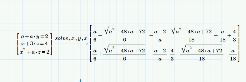

A small correction to your statement "...3 pairs of responses...":

Not really, given the fact that you didn't write my initial equations correctly...
The first equation was x + a*y = 2 ,
not a + a*y = 2 🙂

Sylvain,
sorry about that. Corrected here:
I still think it is two sets, rather that three pairs.
You have to take all three: x, y AND z, from either the top row or the bottom row.

Based on past experience, this would be my prognosis for Prime 5:
December 2022 or January 2023.
