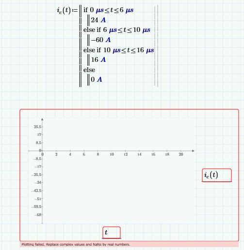

I have been plotting current passing w.r.t time in Mathcad Prime 7.0. But it gives the message, "Plotting failed, Replace complex values and NaNs by real numbers". It is a simple program and there are no complex values and NaNs. I can't figure out what's the reason for this failure.

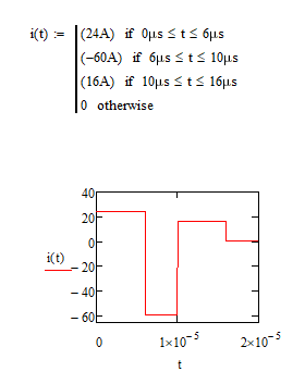

But when I plot the same program in Mathcad v15 it plots successfully with no error. I am wondering whats the problem with Mathcad Prime 7.0. Is it a bug?

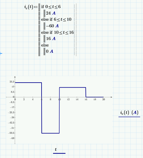

One of the things Mathcad 15 would do that Prime won't is automatically plot from -10 to 10 if a graph denominator was not defined.  Your issue has a simple fix:
@Fred_Kohlhepp  As far as my experience is concerned prime can automatically plot from -10 to 10 same as Mathcad v15. Moreover in this problem when I undo the units of microseconds it plots automatically.  I can't figure out why it does so?
Also if we define a range variable the file size increases 5 folds. It is not feasible if we have a lot of plots in the worksheet.

Sorry!  Thought I had your answer.  I can recognize your concerns, but I like to carry units whenever I can.

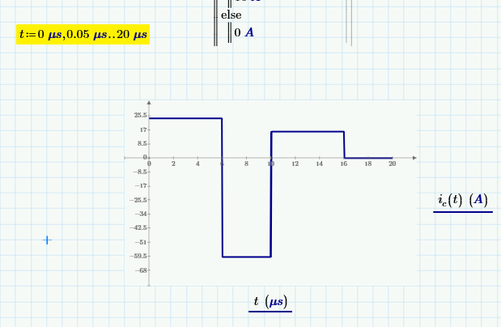

I set out to see how little I had to modify your sheet to get the plot to work.  See if the attached will help:
