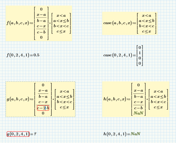

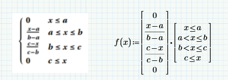

@StuartBruff wrote
As an example, look at the if-elseif-else replacement for if-otherwise.   if-otherwise certainly needed a rework, as it had ambiguities and could be difficult to interpret.  However, it was vertically compact, which its if-elseif-else is not.  Moreover, given that one of the much-touted features of Mathcad is its heavy use of mathematical notation, why did we get a programming notation instead of the standard piecewise brace notation (additional to, yes, but)?  I've yet to see a mathematical paper use if-elseif-else in place of braces ...
You can get close to brackets thanks to the way Mathcad treats vector dot products:
@Fred_Kohlhepp wrote:
You can, but a problem with this approach is that Mathcad evaluates all of the expressions, unlike with a conditional.   This means that situations could arise where a value for any of the clauses can lead to an error, even though it is not selected.
In the rather contrived example for function g below, x = 1, implying the second condition is true, so g(1,a,b,c) should, in principle, return ½.   Instead, it flags up the divide by zero error in the 3rd expression.
function h has a NaN as one of the expression values.  Consequently, the scalar product of expressions and conditions has NaN • 0, which results in a NaN.  This is turn gets multiplied by the correct value of 0.5, but 0.5 times NaN = NaN.
And, of course, it may be that each of those expressions takes a long time to evaluate, thus slowing down the function, which can become problematic if the function is used many times (eg, over a large, closely-spaced set of values).
