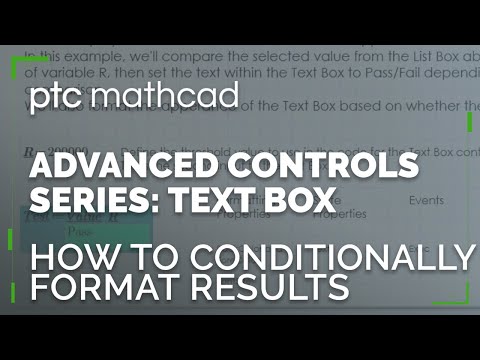

1 See this video https://www.youtube.com/watch?v=SG5UUVC4B2s
It shows how to conditionally format results based on the result.
Cheers
Terry
This video explains how to create a Text Box as of PTC Mathcad Prime 10. Text Boxes are highly versatile controls, and of all of the controls, have the most customisation in appearance. This makes Text Boxes perfect for conditionally formatting the display of your results; for example, by changing
