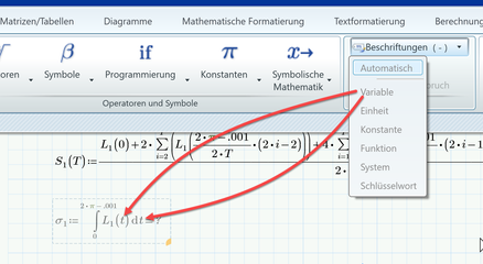

(To:prajendran)
Look at the picture. It shows German menus but you should be able to find out where it is in your version.
Both "t" must have the same label - either both "variable" or both "automatic" (-).
If you do so the integral begins to work. Not sure how long it would take it to finish.
Worksheet attached
