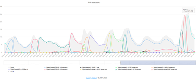

This is the statistics of downloads and it tends to grow.
