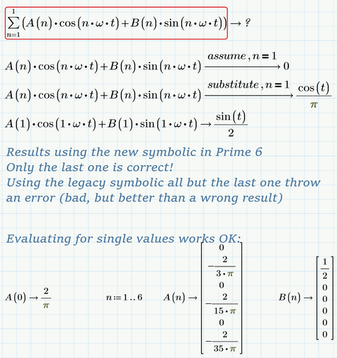

2) Division by zero: Unfortunately the symbolic evaluation does not take in account the case n=1 when using the summation. Its able to evaluate A(1) and B(1), but not in a sum. You may call it a limitation or you may call it a bug. Here are a few more strange (and definitely wrong) results using the new symbolic in Prime 6:

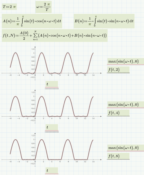

If you are not in desperate need for a symbolic solution, you might use a pure numeric approach:
Prime 6 sheet attached

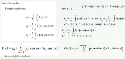

Thank you for taking time out of your day and giving such a comprehensive response. I had a look at the file you provided it was good.
It seems that using symbolic arrow to find the expression for B(n) gives problems however; when this step is skipped and the symbolic arrow is used on just B(n) then it returns the correct 6X1 matrix with 1/2 or V/2 then 0,0,0,0.... which is the correct(refer to the the screenshot).
This is a bit disappointing I have to say but hey; mathcad is still the best in the market.
I am transitioning from Matlab so I am a bit of newbie when it comes to this.

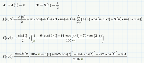

You can get what you are looking for if you define A1 and B2 separately:
The same method fails however if I make the voltage V and additional argument of all functions 😞
