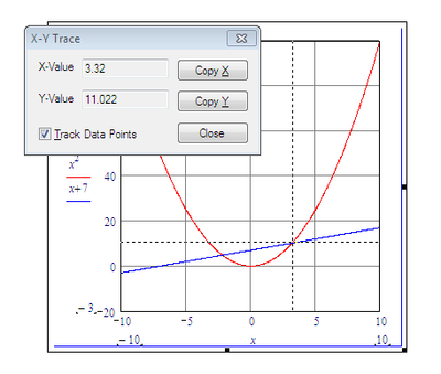

LucMeekes
(To:Sergey)
You mean like this?
Sergey
(To:LucMeekes)
Hello Luc.
Yes, it is.

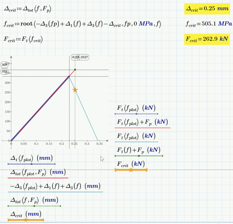

Sergey
Sergey
(To:Werner_E)
Hello again.
Please, find an attached file. I need to find a intersection point between the outermost vertical marker and "aqua" colored line.
Best regards,
Sergey
(To:Sergey)
You typed manually 0.252 in the placeholder for that outermost vertical marker.
That would not change automatically. I guess it should have been "Delta.tot(f,F.p) / mm". You can type this in the placeholder (making it unitless by dividing by the desired unit is mandatory) and the plot later still will show the number. The same goes for the other markers.
Are you looking for something like this:
Prime 6 sheet attached
Sergey
(To:Werner_E)
Hello.
Yes, it is what I wanted.
Thank you for help.
