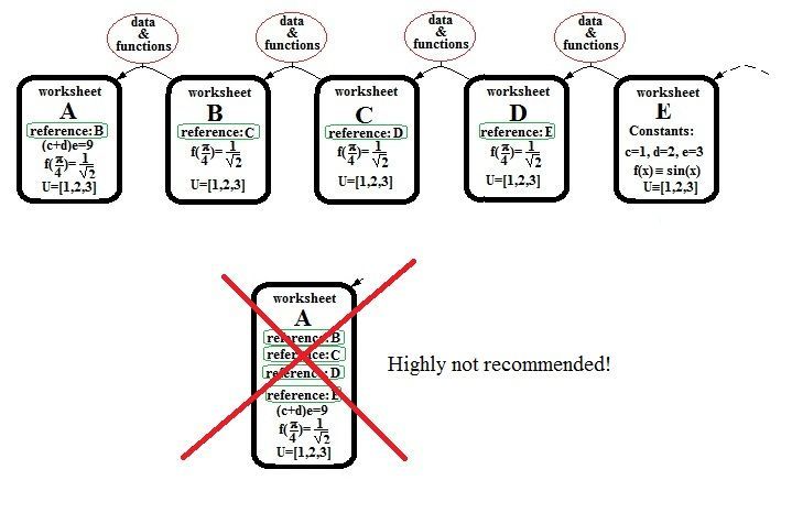

Check your reference structure for a reference loop.
Your reference structure should be a tree. Branches are allowed, but you should not have two branches reference the same leaf...

that doesn't seem to be the problem. My structure is as in the sketch below. Sometimes source 2 is identified as having an error and sometimes source 5. This is what puzzles me. The unreliable, intermittend nature of the refernce function in prime. First I saw it a neat i.e. the simple way to insert it by a keyboard short cut but then I noticed how sluggish it is and then the reliability issue.

Picture was lost. Simple cut and paste appears to work, but still doesn't. You have to save the picture and insert it using the 'Photos' button...
Yes, that's OK. Now the question is what is in each of the references.

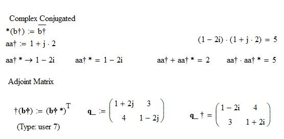

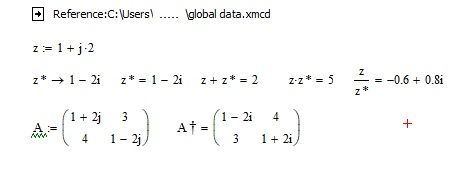

In the reference files, excluding the names of the functions, any other variable or constant defined in them, must be unique; that is, if in a reference file, there is x := 2 in the main or calling file, there cannot be x := 3 so you should define in the reference not x := 2 but x _ := 2, and so on. This applies to M15 but should also apply to Prime.
In a reference file, for example, I have the following definitions: the complex-conjugate, defined with the asterisk symbol and not with a strikethrough letter; the adjoint of a matrix, defined with the sword symbol. The variables in the same reference file have a subscript so that they are not redefined in the calling files. See the following picture (of course b-sword and aa-sword are names, while q_ sword is intended as the action of the sword operator (adjoin operator) on q_. Name of the file reference f.e. "global data)
