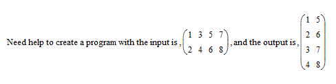

Hello Everyone.
From :
Thanks in advance for your time and help.
Regards.

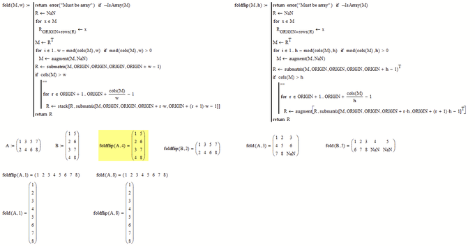

There are so many ways to achieve this simple task.
As Luc already gave you the functions "fold" and "flipfold" in the course of a similar question, I modified his functions so you can also use them for the new problem:
Worksheet in MC11 format attached
