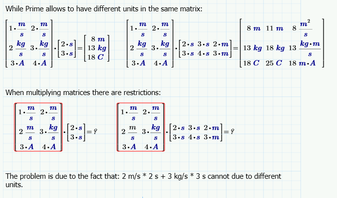

The first was multiplying a transformation matrix by a stiffness matrix, I got an error stating the units were incompatible.
Removing the units from everything solved this.

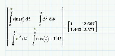

The second was an error with integrating inside a matrix. It said nothing was defined and I couldnt redefine any variables. It was like they were stuck with the origional variables. to solve this, I did the integration by hand instead.

And to answer your first question:
And here's an example of integrals as matrix elements:

My units issue was definitely because of the unit less 0's in the equation.
And the integration issue I solved by integrating outside the matrix and the plugging that value in.
But I did learn a bit from that graphic too!
