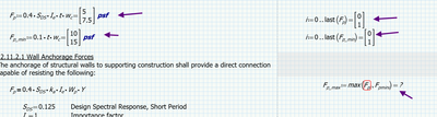

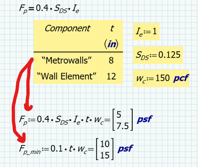

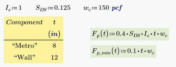

Hello.
I have a table that generates two sets of info.
One is the actual design forces, and another is a minimum.
I want the maximum from each case.
For the 8" wall I want it to give me 10 psf and for the 12" wall I'd like it to give me 15 psf.
I have googled but no luck.  I can create a max function but it gives me the maximum of all four numbers.
There a way to do this?

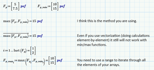

I, like you, commonly make lists/arrays of different elements or scenarios that I want calculating, so I only run through the calculation set only once, not having to duplicate everything for different scenarios/elements.
Where I need to I will use "vectorization" (search it in the Mathcad help file).
But the min/max functions will take all the elements of the arrays/matrices that you throw at it, even if your using "vectorization".  You need to use a range array in order to limit the data that the min/max function have access too:
I typically use ORIGIN:=1 and if you use zero, the range variable will be 0..last(Fp)

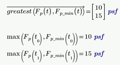

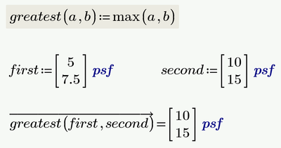

Feb 19, 2025 11:08 PM UTC
We cannot vectorize the "max" function directly, but we can vectorize a user-defined function which uses "max". I called it "greatest" in the screenshot below. Name it as you like but try to avoid names of already existing variables or functions (so don't name it "max").
That way you don't have to define range variables which I usually try to avoid unless I really need implicit loops.
Instead of struggling doing all calculation with initially defined vector arguments, you may consider turning your calculations into functions in the varying variables.
That way you later can evaluate these functions for any input variables and compare the results of different inputs side by side
But you still can call these functions vectorized using a vector of input values if its needed
The max values can then be determined either using the aforementioned user-defined function or by single evaluation

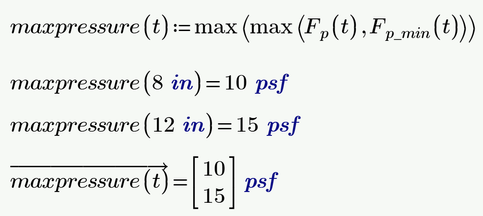

You may also consider defining a function which return the max value for any given value of t.
For future questions: its always better to attach the worksheet along with your question!
Prime 10 sheet attached

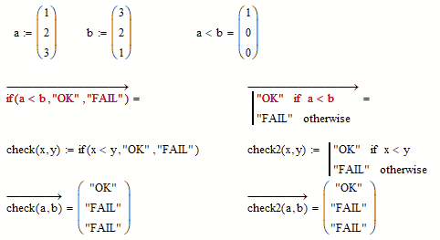

Feb 20, 2025 2:19 PM UTC
Do you know why max/min functions can't be vectorized?
Actually, no. It may be because max/min also natively accept vector arguments, but then vectorization should make clear that we intend to feed the elements singly as scalars into the function.
We have a similar problem with the comparison operators (or is it rather the if-function AND if statement?) which also won't accept vectorization
