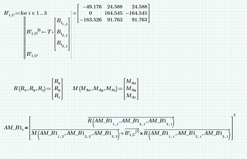

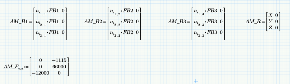

1°/ i write mechanical component:
obviously expressed respectively at each point
Now, i want to solve it find FB1,FB2,FB3,X,Y,Z

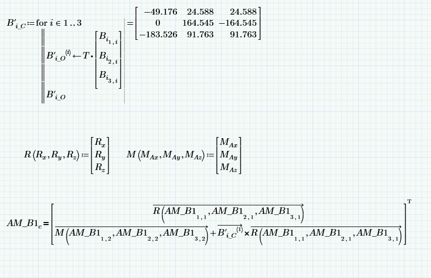

For this, i want to make a torsors transportation on C point!
And now! i am stuck😥
I make a light mc file for add to this post

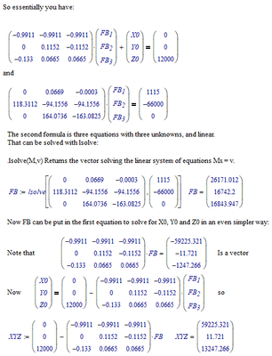

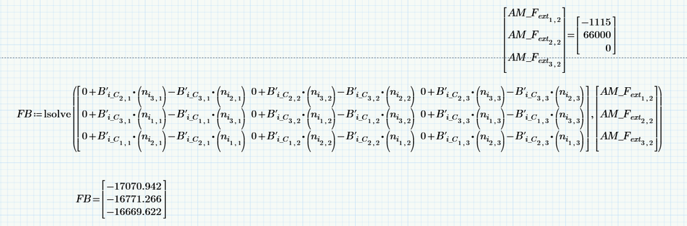

And after all torsors transportation, i want to solve the system like this example:
Resultant theorem:
/ X : -0,9911.FB1 -0,9911.FB2 -0,9911.FB3 +XO = 0
/ Y : 0,1152.FB2 -0,1152.FB3 +YO = 0
/ Z : -0,1330.FB1 +0,0665.FB2 +0,0665.FB3 +ZO -12000 = 0
resultant moment theorem :
/ X : 0,0669.FB2 -0,0003.FB3 -1115 = 0
/ Y : 188,3112.FB1 -94,1556.FB2 -94,1556.FB3 +66000 = 0
/ Z : 164,0736.FB2 -163,0825.FB3 = 0

I can to solve it with pen and paper, but i can't do it with mathcad
I can see that there is a problem with symbolic evaluations
My answers are different from yours. I may have made an error somewhere...
Anyway, you should be able to do this in Prime.

It is possible to keep the formalism of mechanical load, because it's clearer for mechanical readers
I rewrite first matrix, in second equation , with correct values

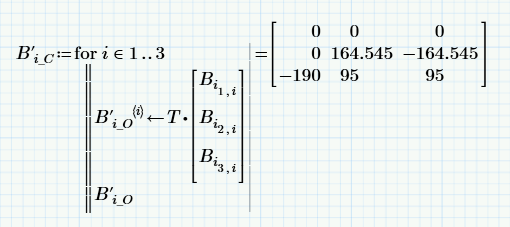

But i see a problem in first line
if i solve that
the calculation does not converge ...😓

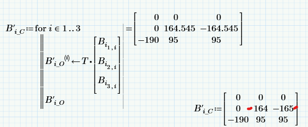

it's strange
if i rewrite the vector value: i modify the red point value
The matrix is now:
And the calculation is done

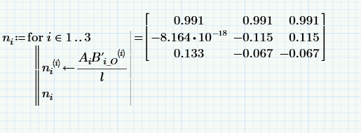

I don't see a compelling reason for these programs of yours. You can just write:
and
to get the two matrices.
see attached file

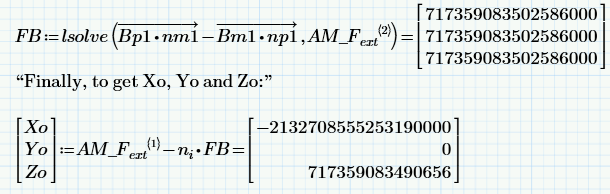

it's strange, i copy paste in new sheet.

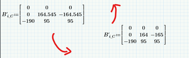

If i switch this matrix
The calculus run but it's wrong
if i use the matrix as in picture, the calculus is good
if i switch , it's wrong
For the upper left matrix, the determinant is 0, it means the matrix is singular, or in other words, it cannot be inverted.
That means that lsolve cannot find a solution.
For the lower left matrix that's not the sae, and lsolve can find a solution.

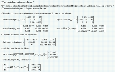

however there are other things that don't work
If i move the Bpoints the geometrical value was changed.
The calculation run

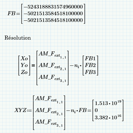

but key result are curious ?
If i calculate this manually, i find approximately:
FB1 = -202569,41
FB2 = -194324,39
FB3 = -194325,75
XO = 584902,22
YO = 0,16
ZO = 13455,71
and the worksheet give
see attached full worksheet (sorry it is written in french)
