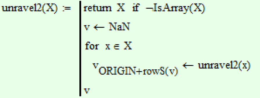

Hi , I woul apreciate if someoane can help to convert de nested array in a  matrixnested.png

How could the program be modified if the origin is 1?

As far as I can see the program should function with any value of ORIGIN.
So no modifications needed.
(To:rcallisaya)
Luc is correct - my function should work OK with any value of ORIGIN.
At the top of the function I assign the value of ORIGIN to a variable O.
You must take care that throughout the function you are using O (the letter) and not 0 (zero).
There is not a single zero in this function - whatever looks like a zero is a capital letter O.

I should think that the very same program can also handle this nested matrix.
You did not provide the matrix, just a picture of it. Assuming you have it as a (nested) matrix, just supply it to the function.
(To:rcallisaya)
OK, I see the problems:
1) The routine I provided did not work OK with matrices of just one row or just one column
2) Your matrix PP is even nested one step further than the example you provided in your initial question and so my routine would not deal with it correctly.
Any of the following three  functions should fix this and should work with any nesting level and of course any value of ORIGIN - take your choice:

You may even try in on multiple nested matrices

@rcallisaya wrote:
I would also appreciate knowing how to generate the vector cc1. Thank you
You didn't read my answer, did you?
You just type cc1:=unravel1(gdt) (or use unravel2 if you like)
BTW - you don't need to use the function "rowS", you may use the built-in function "rows" instead.
The vector cc1 you ask for is the very same as the vector cc you asked before.
