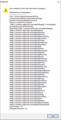

Im new to using MathCAD and i suddenty can't open my file.
It says my file is corrupted?
This is the message i get:
Does anyone knows how I can fix my file? Or maybe even fix it for me? 🙂
I have attached the file - hope you guys can help me, thanks

The file somehow got corrupted and its sure the best option to use a current backup.
I deleted two regions which seemed responsible for the error, but when I open your file, some regions are displayed in a very strange way (the regions look correct while they are edited)
This display error affects all regions in which variables or units occur in fractions.
"Repaired" File attached
(To:Werner_E)
Hmm, strange.
I closed Mathcad, opened it again and loaded the repaired file and ... no more display errors.
For whatever it may be worth i resaved it and attach it here
Wow that was quick 🙂
Thank you so much for the help 🙂
