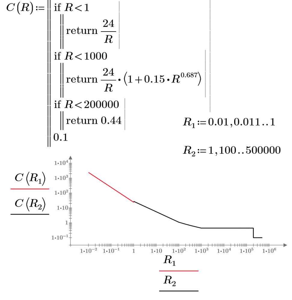

Hi, I am trying to do this workshop as shown in the attached picture. I am a new user to MathCAD and it needs to be done using MathCAD. It is an iterative calculation to find parameters related to the terminal velocity in a settling equation. In this case, the desired terminal velocity of the particle is known, I am trying to find what the associated diameter D for that velocity would be, given a certain particle density p_subp. Reynolds number is R, Drag coefficient is C, as defined by the equations in the picture. you can rearrange the velocity equation in terms of v or D as desired. The physics part is easy but I am having the following issues.
Since C is a piecewise function based on value of R, I have used if/else statements to determine value. However, MathCAD highlights the inequality Re<1 for C <-- if Re <1 and says "This value must be a scalar" This also comes up for the R<1000, R<200000 terms. Any fix for this?
If that can be fixed, it is part of a while loop I have shown in two alternate ways, either until v converges to a desired v (0.5m/s or I can show as the variable v_terminal), or by convergence of the drag coefficient C, which I have tried to compare to the last iteration via a dummy variable K, within 5% or 0.05. Since C, R, and D are all interdependent, I would appreciate any feedback on how I should set these loops up, or where to state a return v or return C or return D, etc.

One problem are the square brackets around the number 1111 in the definition of p.p. Square brackets create a matrix/vector - in your case a 1x1 matrix and this matrix cannot be compared to a number as you do when you write "if R<1". Hence the error message you show in the picture only.

See if the attached file helps, and read up on solve blocks as functions.  File is Prime 4.0 Express.

The brackets were the main problem. Things went more smoothly after this. Thanks a lot.
