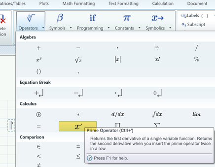

How did you type the prime symbols for the derivatives?
You can't simply type quotes but have to use the derivative symbols from the operators menu.
If you are happy, they keyboard shortcut ctrl+' works for you (it doesn't in my version - I have to type ctrl+ä on my German keyboard!).

I think I was entering the primes correctly for the derivatives. I selected them from the menu Math/Operators/Calculus/x'
I uploaded my file in a reply to an earlier post if you want to take a look at it.
