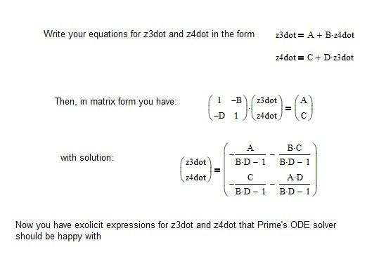

I can't see your Prime file, but judging by the PNG file, you need to do something like the following:
(for "exolicit" read "explicit" !!!)
Alan

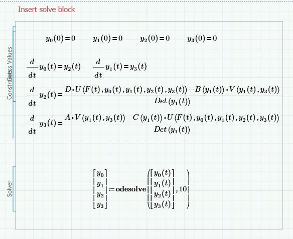

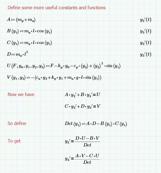

Attached is my Prime 2 working version (no idea if the results make sense or not!!)
g0.JPGg1.JPGg2.JPG.
Alan
