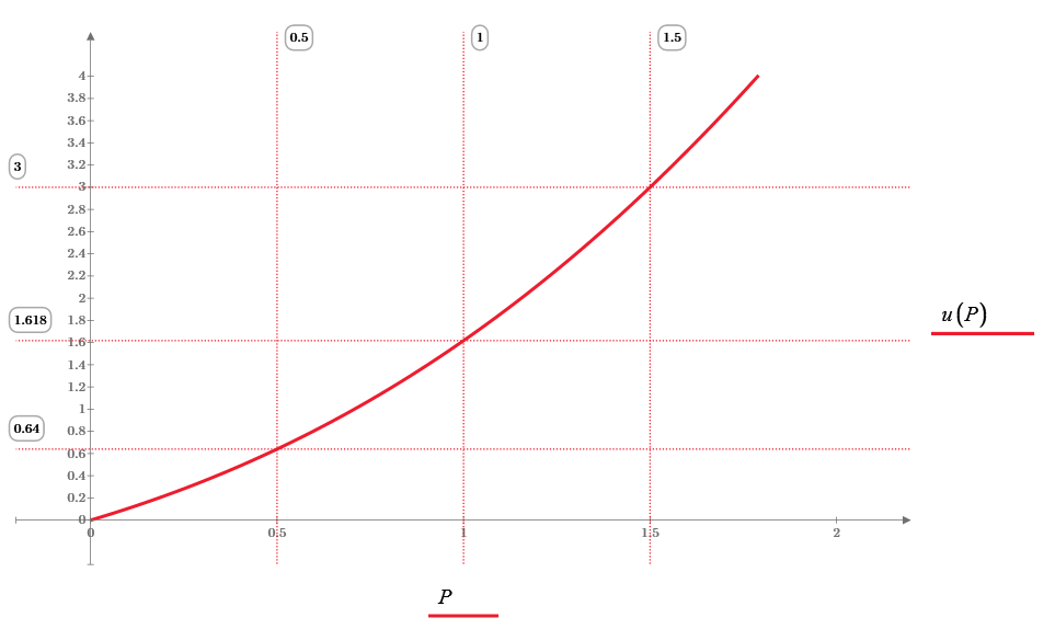

Attached is Mathcad 11 file. I also converted it from Mathcad 15 to Prime7(attached).  I did Nonlinear/ iterative solution in a manual way and another one with a small program at bottom of sheet. I have two load increments. In the manual way, it took two iterations per load increment to converge. When I compare the manual way to the little program:
1. Results matched in both methods for the first load increment , where you see green arrow and u=0.635.
2. Results didn't match for the second load increment. Manually, I got (u=1.613) after two iterations , but by the little program I got (u=1.599) where the red arrow is in the sheet ( please scroll down until you see the red arrow). Little program is shown at the bottom of sheet. For some reasons it shows a different number of iteration by the program.
I appreciate any assistance!

There are differences between your step-by-step 'handcalculation' and the program.
Just one:
Your program uses DeltaP as an input, and it is set to half of P (which is 1), so 0.5.
Your handcalculation uses epsilon0 for the same 'thing' (Why use different names..?) wich is set to 0.5 for the first iteration.
Then before the start of the second iteration you calculate a new value for epsilon0, and it comes out as 0.5035.
You program never recalculates DeltaP, so that parameter keeps its value of 0.5.
Now 0.5 is close to, but not equal to 0.5035.
You should expect different results.

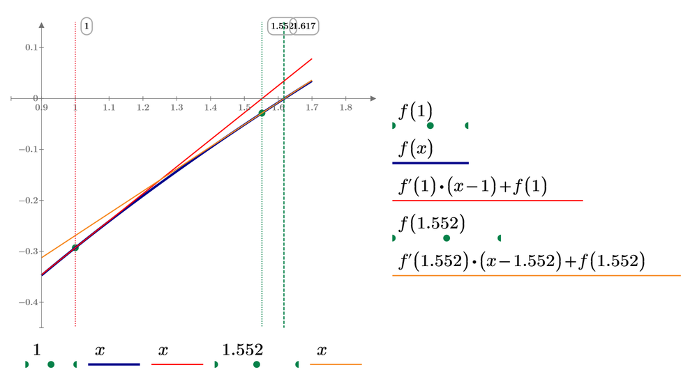

Hi Luc,
Delta P is for the size of the load increment, however "e0" is not equal to Delta P. "e0" is the magnitude of error in an iteration. In other words, when the e= ([applied force] - [reaction force] )> [e max= error tolerance], then I had to do another iteration. At the start of the second iteration, the load is=1.0 but the reaction force obtained from the end of increment is 0.497, so I had to calculate the Delta u in this iteration =0.799, and added to u0 from the end of previous increment to get u0+Delta u=1.434. The hand calculations are the correct values. I am attaching a new file after making some changes.
