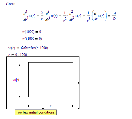

I am trying to solve a differential equation for a clamped Circular Kirchhoff-Love plate.
Why am I getting this error in my displacement function w(r)?

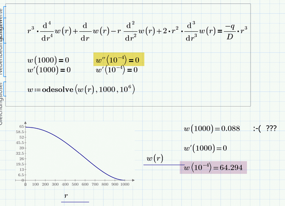

So we can't use w(0)=0 as initial conditions as I did and you need to provide a new fourth condition.
How about w''(0)=0 ?
EDIT: I am not into mechanics myself so I am not sure but maybe Chapter 4 here
http://imechanica.org/files/4_Bending%20of%20plates.pdf
can help you to find two reasonable additional initial conditions.

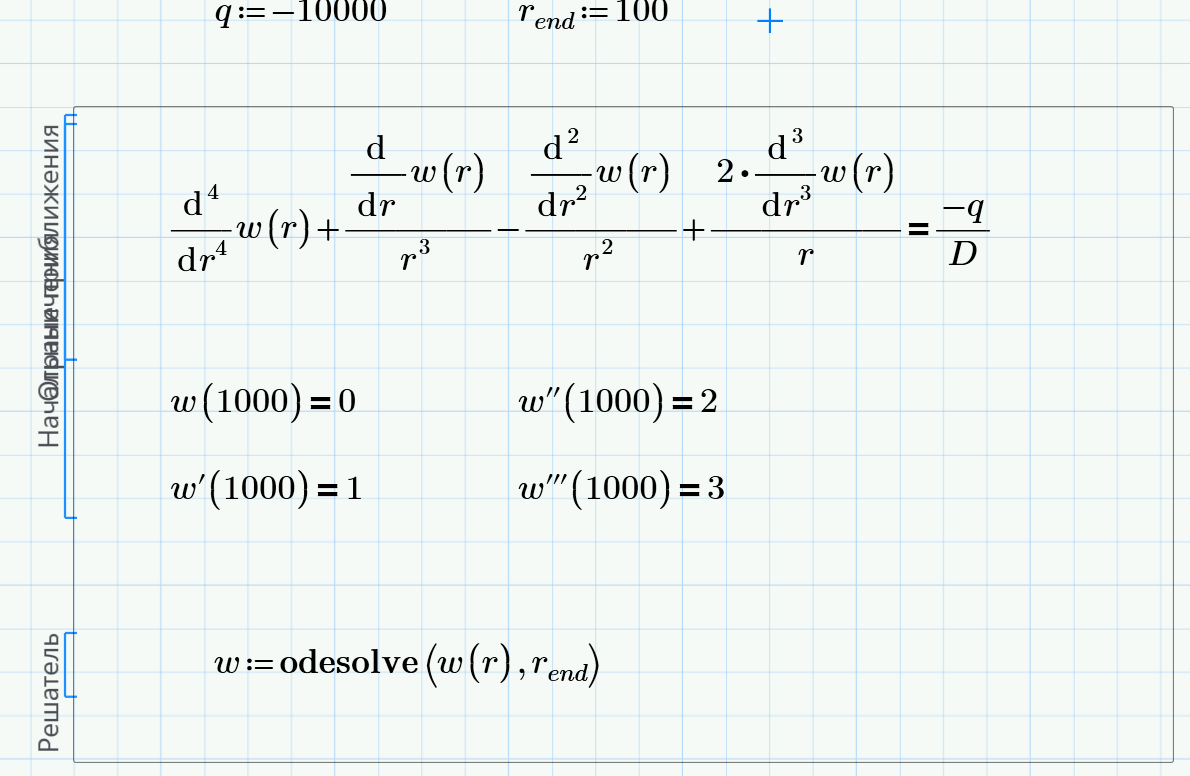

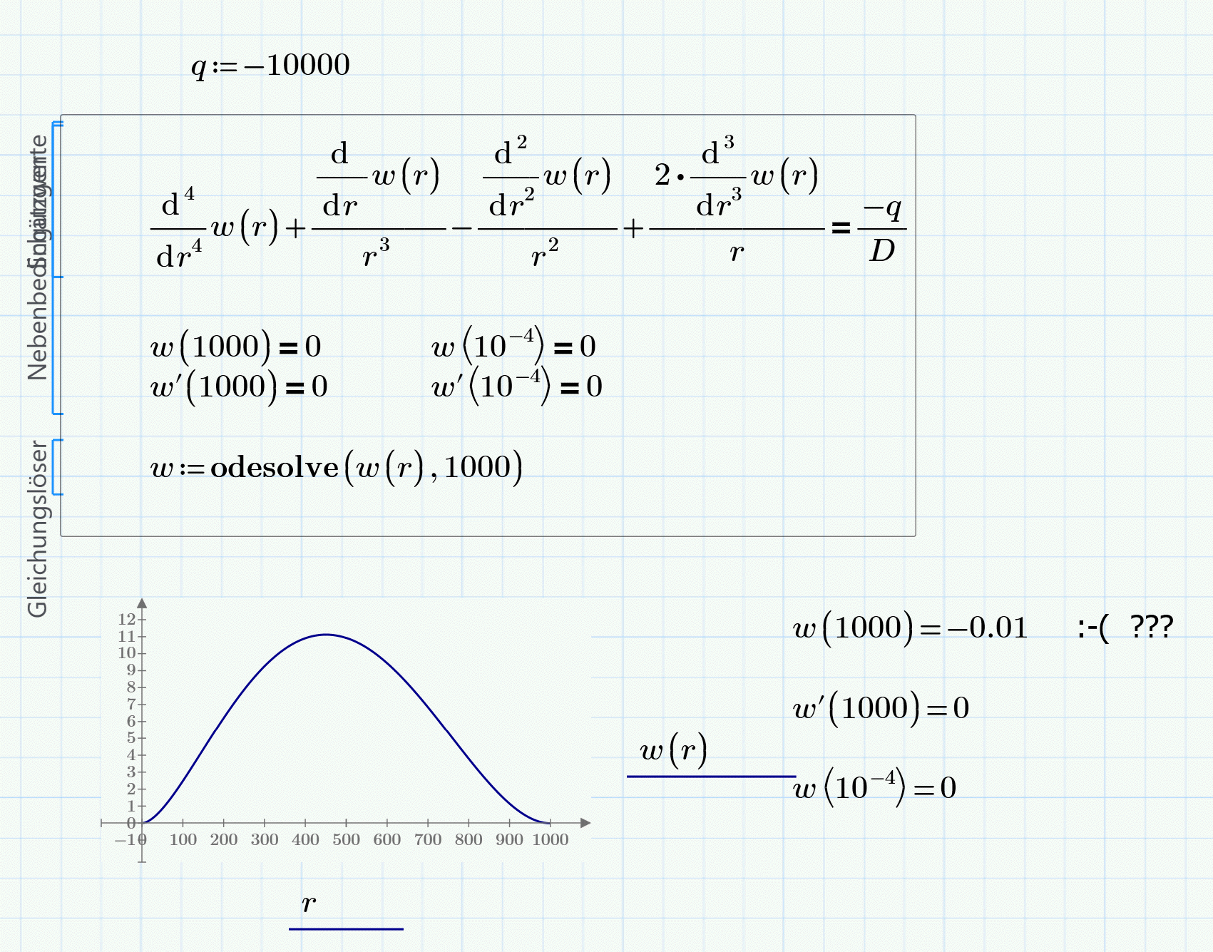

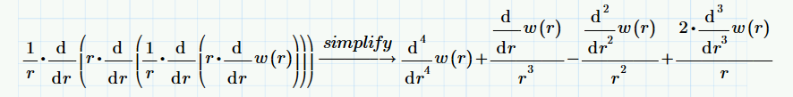

You have to expand the nested derivatives to make it work (best done symbolically, like Fred had shown) and you have to add two more initial conditions:

Probably because you're trying to solve a fourth order differential equation
Oh, so what are the restrictions when trying to solve differential equations?

I would have expected 4 initial conditions for a fourth order DE, not just 2.

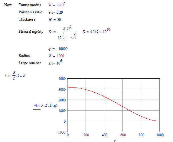

In the meantime I played around with Mathcad 15 (much faster and more capable and comfortable) and assigned arbitrary values for q and D and added two more initial conditions.
You can't use w(0) or w'(0) as your expression is not defined for r=0 (divison by zero!)

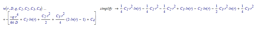

Maybe I'm missing something, either from my calculus classes or from my applied mechanics one. But can anyone here help me in getting to this (image attached) without actually utilizing the analytical solution?
LucMeekes
(To:lferreira)

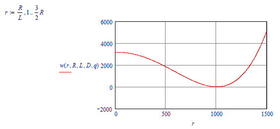

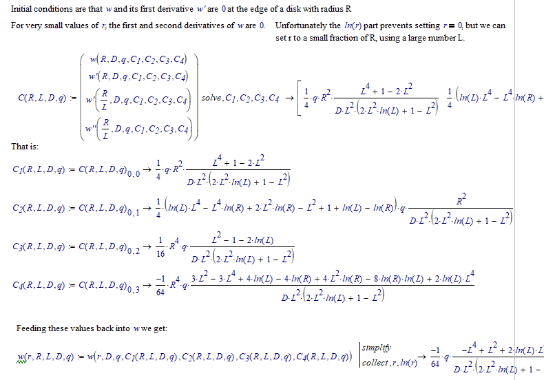

Here's the full solution for any value of q, D and R(adius of the disk):
So with that we should be able to continue as follows:
This function is large, but that does not prevent us from using it:
And we can even see what it does (or would do) for values of r beyond the size of the disk R:
Notice! However that my result differs from the one your picture, when I subtract them I don't get 0:
So far I wasn't able to locate where I went wrong.

I get this:
Too few initial conditions...{also when the second is correctly written as w'(1000)=0}
You must add two (it's a fourth order).
