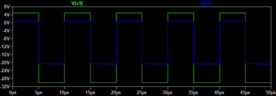

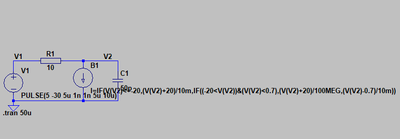

It's not an Odesolve BUG, it's just complications of numerically computing the voltages and currents, given the non-linear /discontinuous behaviour of the derivative of the diode function I(Vx).
There are other tools better equipped/specifically geared for this kind of calculations, e.g. LTspice:
(a simple diode model with a breakdown voltage of 20 V) gives:
And with the diode modelled per the I(Vx) function:
we get virtually the same result:
There are minute differences. The top line of V2 here sits at 0.7 V, while with the previous circuit it is at 0.8 V.
Note that the capacitor value is so small, it could just as well be left out. That would render a non-differential equation to be solved.
If the capacitor is increased significantly (as TTokoro did) you'd see some effect of it:
