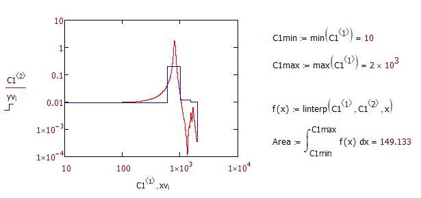

imagine the following. Using the Simpson method for integration by splitting a range [a,b] into n equivalent length. Let’s say I split this range into 2 rectangles. It’s fairly easy to find the “middle” point so that the area A of each rectangle is close to the exact integral
what I am thinking at the moment is if there is a way of “automatically” finding the best positions of say N points so that the area in each “bin” is a close match. If the raw data as a x increment =1 over say [10-2000] range then choosing 1990 points would be an exact match
With the attached diagram
I split the range into 3 areas . I therefore "decided" I want to use a vector {f1,f2,f3,f4} in all cases f1 and f4 are "fixed" i.e. decided by the user. I therefore will have a vector y={y1,y2,y3,y4}
Is there a way of finding the best values for (f2,y2) & (f3,y3) so that
area sqrt(A1) ~ sqrt(A'1); sqrt(A2) ~ sqrt(A'2) and sqrt(A3)~ sqrt(A'3) where the A areas from Curve C1 and A' the areas from the points I am trying to establish
also added a mcad 15 example but needed 5 pts to "look" good. Not checked the areas,etc

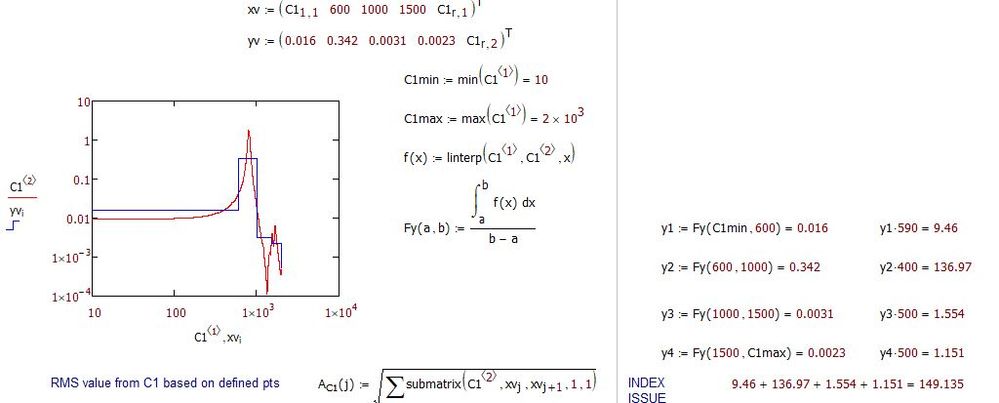

Did some searches on the Gauss integration-attached pdf. It is what I am trying to do but I do not know if the "solving" can be done in mcad. I suspect it can. Might be a minimisation problem! I think I started laying out the problem  a bit better and the "key" step is how to use and set up the 'Given' block
Is this what you mean by finding the y values?
I think so.
I'll have a look as I need to correct a few thing in the posted sheet - I need to modify it so that I deal with "sloping" rectangle (trapezoid) rather than rectangle as this approach is too limiting and woudl only work is very few special cases (when I get to the real "thing")
May need a loop
start with (x1,y1) (x2) find best value of y2 to match the area A1
use (x2,y2) and x3 find best value of y3 to match the area A2
and so on
the selectin of the x values will always be a user's choice
