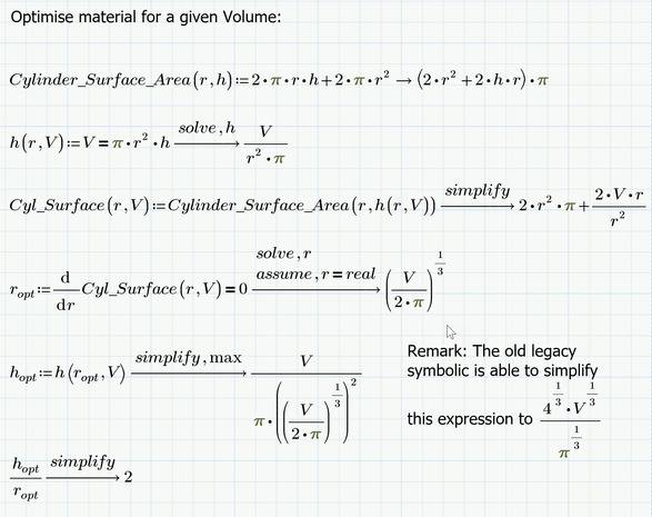

New to Mathcad, I'm trying to understand and provide a long hand example of how mathcad can optimise equations with proof so that I can show the calculations and then move onto solve block at some point. However, the last steps to rearrange the equation by setting it to "0" and solving has stumped me, in order to obtain the critical points!. The attached file shows where I've got to. Can anyone advise how I might expand this and achieve my aim ? Thanks.
Solved! Go to Solution.
Looking for something like this:

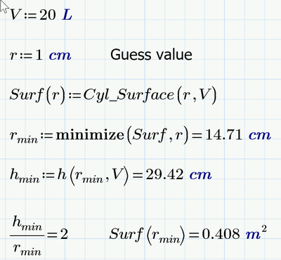

If you want Prime to do the minimization you would use the "minimize" function, but you can only do this numerically - meaning that you have to provide a value for V and you don't get the exact result (with pi and roots, ...).
Prime 6 worksheet attached
