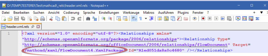

The reference to the FlowDocument#.XamlPackage containing the the text of the header resp. footer are in mathcad\_rels\header.xml resp. mathcad\_rels\footer.xml .
In the attached file test.mcdx (when renamed to *.zip) we can find in the file /mathcad/_rels/header.xml with the reference to /mathcad/xaml/FlowDocument4.Xamlpackage

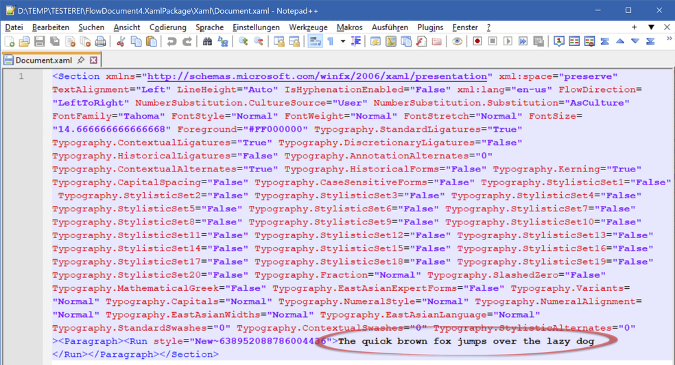

FlowDocument4.Xamlpackage is a zipped file again an when we unpack it we find in /Xaml/Document.xaml the text I used in the header

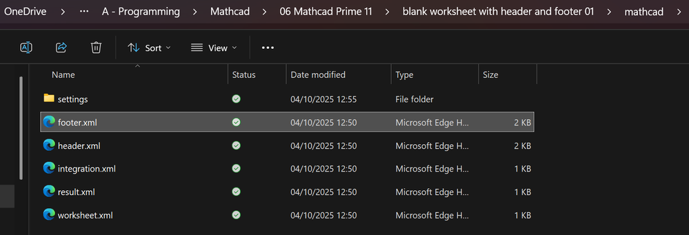

Interesting.  I've just created a Mathcad Express 11 worksheet based on the Blank template, adding only a header and footer.  The header comprises a math region and the filename.  The footer comprises a text region and the <page of pages> data.
I couldn't see the header and footer in _rels, but I did find them in mathcad.

Here are their pretty-printed contents in Notepad++.

Expanding the XamlPackage yields the Document.xaml content as
<Section xmlns="http://schemas.microsoft.com/winfx/2006/xaml/presentation" xml:space="preserve" TextAlignment="Left" LineHeight="Auto"... [Font, Typography & other Settings] >
   <Paragraph>
      <Run style="Normal">This is the footer</Run>
   </Paragraph>
</Section>

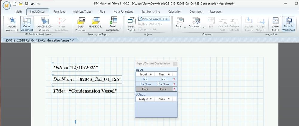

If you are prepared to open a Mathcad template then save as a file you can use the API to open the template set the values at the top of the calculation sheet rather than the header and save with an appropriate filename.

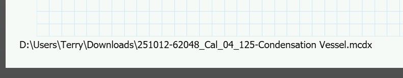

In the footer that shows on every page it is possible to put the path and filename given during save with the API that has the appropriate data in filename.
