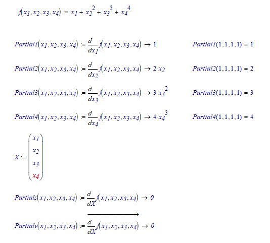

I tend to do a lot of partial differentiation in my analyses and how I currently do it is to hard code each partial to their own variable. This tends to clutter my analyses, since I deal with rather large multi-variable equations. I tried being slick today by defining a 1xn matrix (where n is the total number of variables and each element contains the variable names that I need to do partial derivatives on) and performing the partial derivatives on that matrix and vectorizing it. Mathcad doesn't flag an error, but what it's calculating isn't correct. I believe it's trying to do the differentiation on the value of the variable rather than seeing it as a variable by itself, because it always calculates the result as 0. Does anyone know how I can get mathcad to see these as variables or know I better way of going about this? I've attached an example of what I am attempting if it isn't clear in my writing.

I see a few problems, solving of which - may - help:
1.
You have (x3)^3 in your matrix X, guess that's not what you intended...
2.
X is a matrix (1 row, 4 columns), Vectorization may only work with a vector (4 rows, 1 column). It just might help to transpose X...
3.
Try symbolic evaluation, instead of numeric, and make sure x1 through x4 are not defined when differentiating. Don't define them in the first place, and/or make Partial a function of x1 through x4.
This is done in Mathcad 11:
The last two items:
f is differentiated to X (which as a symbol, is NOT a parameter of f), so the partial derivative is 0.

1. Correct, that was just a typo
2. I use vectorization on 1xn matrices all the time, it should just go through element by element. Either way, I have tried just transposing it and it still returns 0.
3. I am not following how I'd be able to do that? How would I set up a symbolic expression without defining my variables when I intend to use a matrix for those variables? Also, setting Partials as a function of the variables just flags an error.

Why would that flag an error (unless you're using an equals, that is, a numeric evaluation, at the end of the definition)?
My opinion: While it is supported, I think it is bad practice to append a numerical evaluation to a definition. We've had more users complaining about errors due to this. It results in errors because the numeric evaluator cannot handle undefined variables. (Important note: the symbolic processor and evaluator has no problems with undefined variables) So: Define, then do the numeric evaluation separately.
