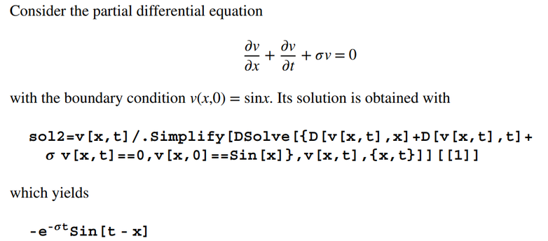

I saw somewhere in wolfram mathematica that it is possible to obtained relatively "easily" the solution of this partial differential equation. Is it possible to obtain somehow the solution also in Mathcad Prime 10?

You know that Prime could not solve differential equations symbolically for a long time.
It relatively new that Prime can solve some simple ordinary ODES symbolically (using "solve"), but still no PDEs.
Its just a few version that Prime re-implemented the "pdesolve" command which, similarly to "odesolve" is a numeric only feature.
