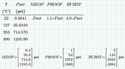

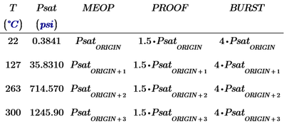

Tables in Prime are just for input of static data. You cannot use them for output, and any expression you use must use defined data (numbers or variables), Note that while defining a vector, the vector itself is unknown. Means you cannot define:
But fortunately, the vector Psat is known at the definition of MEOP, etc. so you can:
Note that MEOP, PROOF, and BURST are now based upon Psat, so they inherit their units from it and you shouldn't type a unit in their placeholder.
(Note also that I use ORIGIN, to make the indexing independent from the actual value of ORIGIN, which you set to be 1).
Now you have:

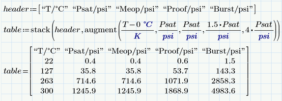

What else you can do is the following:
But here the problem is that you cannot change the display of the units inside the matrix.

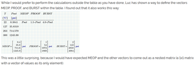

As Luc has already explained, a table in Prime is only intended for entering and defining vectors. It is difficult to perform calculations within a table and impossible to display the results neatly.
While I would prefer to perform the calculations outside the table as you have done, Luc has shown a way to define the vectors MEOP, PROOF, and BURST within the table. I found out that it also works this way:
This was a little surprising, because I would have expected MEOP and the other vectors to come out as a nested matrix (a 1x1 matrix with a vector of values as its only element).

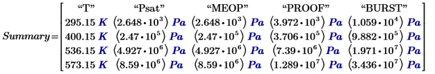

If your actual goal is just  to present results clearly in tabular form, you can create a matrix in Prime with all values and a header row. Luc demonstrated this and pointed out the problem with units that cannot be changed.
This could be circumvented by showing unitless values in the table and noting the corresponding units in the header.

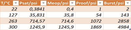

Another option (which I don't particularly like) would be to integrate an Excel component. Here, you could transfer the Prime matrix and then format it as desired using the many options available in Excel.
Inserting an Excel component bloats the worksheet, makes it slower, and unfortunately also more unstable (I just had Prime crash because of the embedded component).
Of course, you could also just transfer the first two columns of your table and have the remaining calculations performed directly in Excel.
