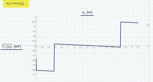

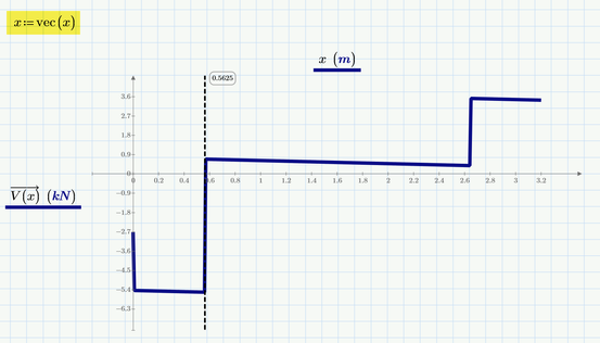

Hi all,
I have an issue with plotting a function on Mathcad Prime 11. For some reason there are missing segments in the plots of my shear-force diagrams. I'm not sure why this is happening, other plots I have made seem to work fine - any guidance would be much appreciated.
The plots and respective functions are on pages 9 and 17 of the attached document. Thanks in advance

Hi Terry,
Thanks for your response, I now realise that the increments I had used for x and x2 were too large, effectively skipping the points where those loads were applied.
Many thanks
LH
(To:LH_13783026)
What Prime is doing is mathematically correct - a vertical line can never be the graph of a function. A step means that there is nothing inbetween.
But I understand that you are used to see that vertical line segment.
Solution is to use a vector for the abscissa values instead of a range. In Prime 11 you can use the convenient "vec" function to convert a range into a vector.
Using the vectors solves your problem.
It depends on the way the functions V and V2 are defined if vectorization when calling them with a vector argument is mandatory. In your case it would not be necessary as Prime would apply automatic implicit vectorization, but I consider it good style to explicitly apply vectorization.

Actually Terry also used vectors instead of ranges in his solution. I just wanted to show that its not necessary at all to add the two special values.
