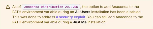

Recommendation from PTC: Put the Anaconda3 directory (where the python binaries are stored) in the path.
This solution works and Mathcad is able to find the Python executable for Advanced Control scripting.  However, per the installation instructions on anaconda.com, they state (emphasis mine):
  • Add Anaconda3 to my PATH environment variable - Adds the path that contains the conda binaries to your PATH environment variable. Anaconda does not recommend selecting this option. The conda binaries path contains other package binaries, which are permanently added to your PATH environment variable, even if no conda environment is currently active. This makes it possible for other software to use these package files, which might lead to errors.
Use at your own risk.
