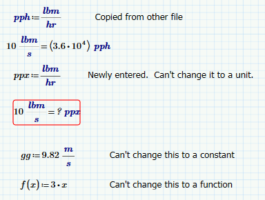

I'm wondering if other users can confirm this issue.  Upon switching to 4.0 it has become difficult to get MC to define a custom unit.  I occasionally had problems in 3.0/3.1 - but nothing like this.  It only works about 10% of the time.  I can paste custom units from another file and they work, but can't define new ones with the label styles menu.  Also having similar issues with defining constants or functions.

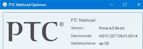

I don't see this problem. Are you running the new bugfix version of 4.0 (M010)?

Interesting.  Yes, I'm running M010.
vlehner
(To:DJF)
...me too:

If I select ppx, and use the math formatting to select, for example, unit, that does nothing to ppx. It shouldn't. It defines what the formatting of units look like, not whether ppx is a unit.

Yep, I think that's it.  Works fine from the Math tab, but not the Math formatting tab.  So another quirk but maybe not a bug.  Still, it should work from both, right?  Anyway, I'll call it solved.
LucMeekes
(To:DJF)
"Still, it should work from both, right? "
NO, it shouldn't!
The  Math Formatting tab controls what your math items (as distinguished by their Labels) look like, and only that. So you should use it to format how you want or need your math items to be presented (font and style).
[You should e.g. use it to set Units to show in upright (non-italic) style, according to ISO 80000 rules.]
Whereas the Label selection on the Math tab is used what your math item means: e.g. whether it's a Variable, a Constant, or a Unit.
Although I strongly advise against it, you could define the same font and style for Variable and for Unit. Then if you define the variable m to be 2 metres with: m:2*m
it shows as "m:=2.m".
Evaluation of m would show like: "m=2 m"
For  you (and me) as persons it would be hard to distinguish the Variable m from the Unit m, especially when only a print-out or picture of the sheet is avaiable, but Prime still knows the difference because of the difference in Labels.
