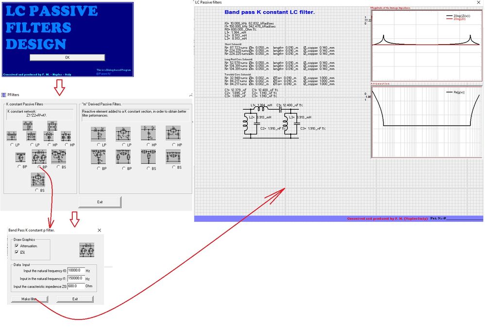

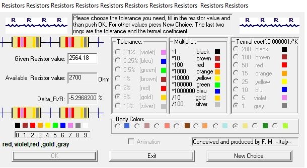

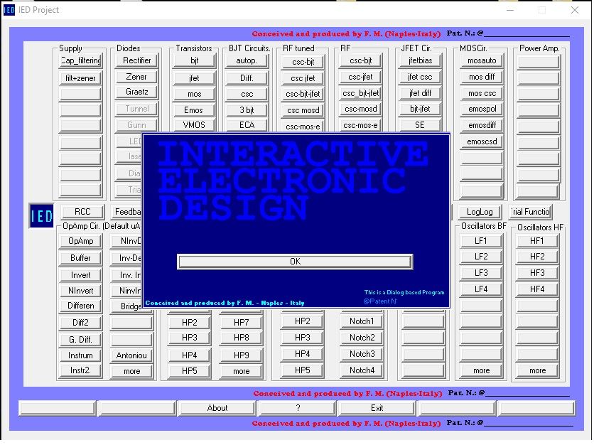

I'm trying it now. I would add that it is slow as a sloth.
For many years I have been developing software using the VC ++ examples:
and a thousand others, but how can you do something so slow?!?!?!?

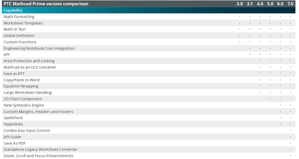

It does not have the same functionality. The only part that was added to P7 from M15 is the Combo box which converts the drop down and check boxes to combo boxes. The text entry radio buttons are not part of the conversion.
Very frustrating when converting as the entire worksheet may need to be rewritten not just from some of these simple interactive boxes but also the font size, area spacing, margins. There is a significant amount of work required to convert worksheets from M15 to P7 to make them functional.
