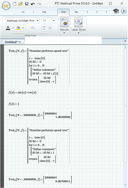

Have dual loads of P9 and P10.  My application is CPU intensive.  Recent testing showed a big difference so I did a simple sum test.  The results are not good in my opinion.  Can this be fixed with a patch?  Bloatware at its finest - added functionality with engine overhead.

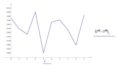

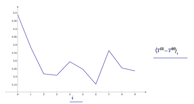

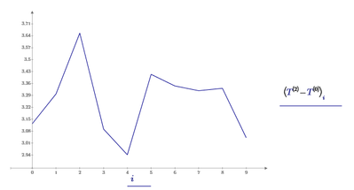

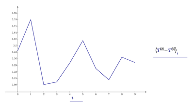

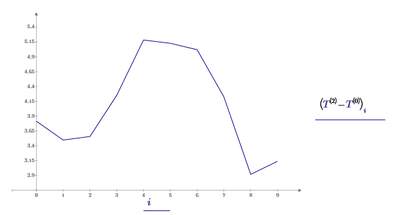

OK, Let's see how Prime progressed over time. Since I'm limited to Express, I had to use a different speed test utility.
Also know that the time() function was a premium function in Prime 1 and 2...
Prime 3.1:
Prime 4:
Prime 5:
Prime 6:
Prime 7:
Prime 8:
Prime 9:
Prime 10:
Notice that there is quite some variation in the speed test execution times.
I ran all tests on the same machine, with just the Prime-version-under-test running during the test. They all loaded the same file (attached, Prime 3.1) and after loading I pressed the 'Calculate' button to have the sheet fully recalculated. Then I took the result.
I'd say Prime 10 is the slowest, Prime 8 comes next.

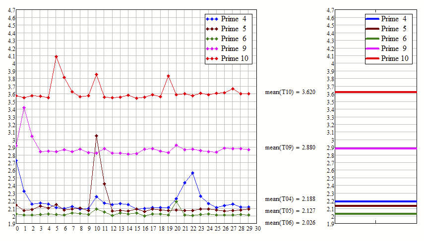

I couldn't resist and I used your sheet (with 30 runs) to test the five versions of Prime installed on my machine.
Nothing running besides the appropriate prime version (and Win10 of course), multithreading turned off).

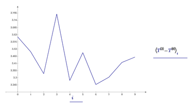

I exported the results via WRITEPRN and made the comparison plot in Mathcad:
'Winner' is again P10 😞

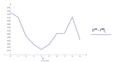

My results are slightly different.   I modified your test a bit to evaluate and compare both the trig function as well as the trivial function that returns 1.  I also calculated both scenarios manually with in a program without passing them in as parameter functions.
I see some significantly slower times if the summation functions are passed in vs. not.  However, I see a speedup in Prime 10 when not passed.  We're measuring 100's of milliseconds here so results fluctuate with each recalculation with whatever else is going on the machine.  After many recalcs, the above screenshot is typical for my machine with nothing but Windows running.  While I do see some increase in calc time when passing the functions in, it is not nearly the 300% increase shown in the original post above.  It's possible this is machine/chip dependent, so I posted my machine specs as well.
