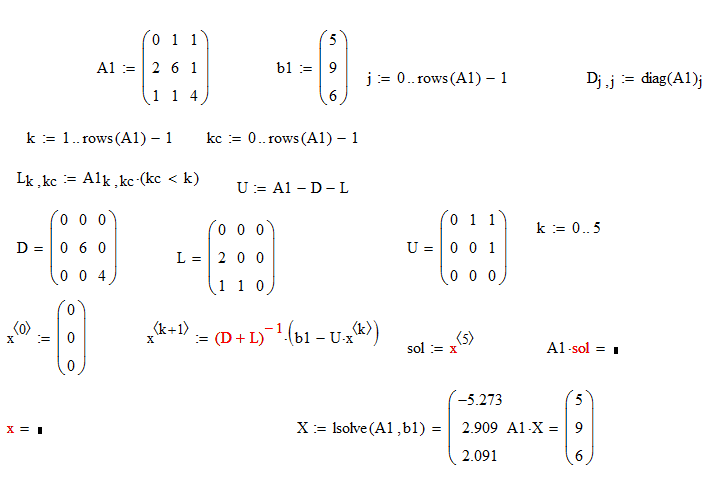

I cannot make to work the algorithm of the attached file containing Gauss-Seidel Operator for linear systems. Can someone give an advice, please? I attached it.

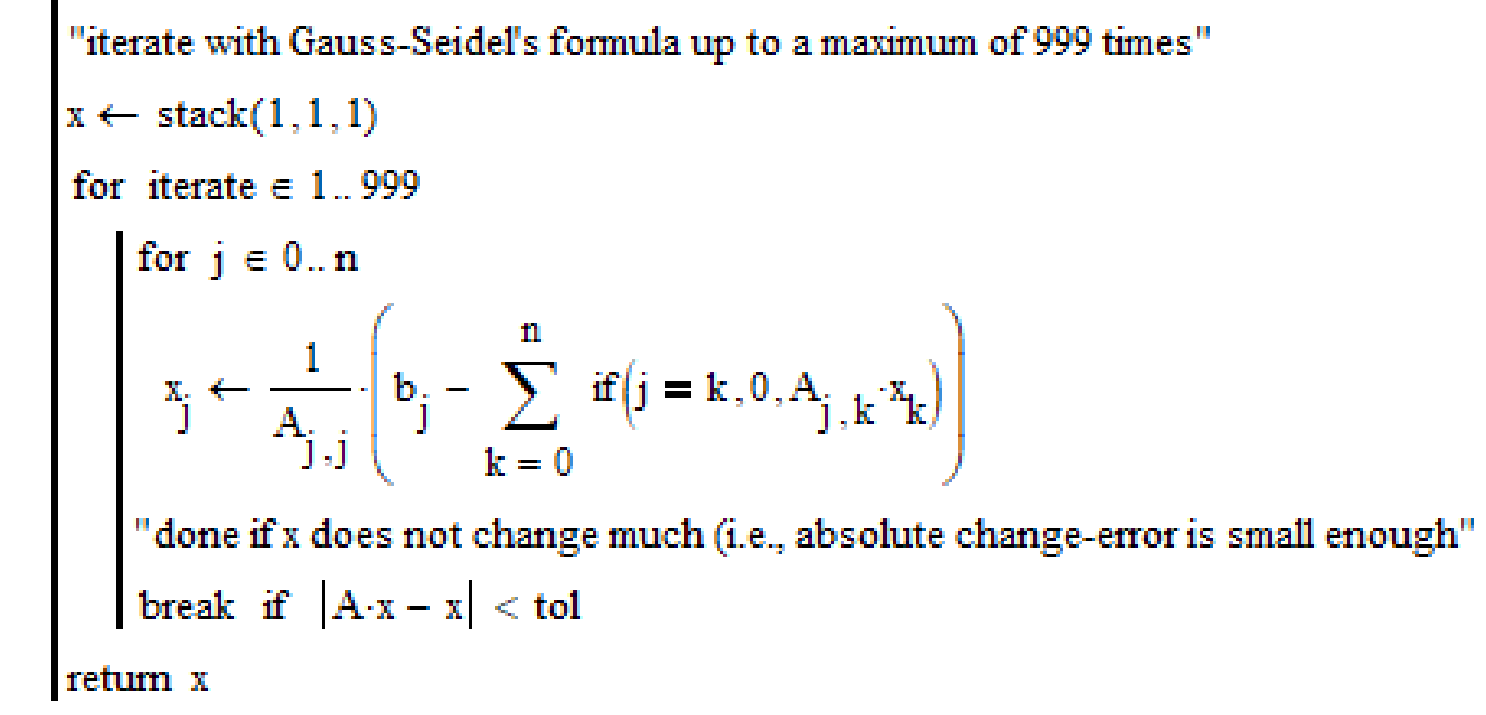

The easiest way still is
You may say thats Jacobi, not Gauß-Seidel. But because of the order in that the (new) x[j are calculated and overwriting the old values, in the sum we use the new, just calculated values as long as k<j and automatically use the old values for k>j as those are not yet calculated and overwritten. Seen that way we its finally Gauß-Seidel.

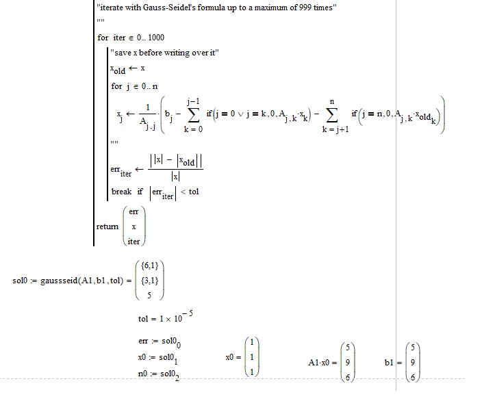

For this matrix it does not converge, why?
On my old pocket calculator (HP 41SX of the seventies) instead, the same example and the same algorithm created at that time, is convergent.
On my old pocket calculator (HP 41SX of the nineties) instead, the same example and the same algorithm, it converges.
Looks like the algorithm you implemented (we don't see it, we only have a picture of results) is not robust enough.
As was already said,  the algorithms in the number cruncher  Mathcad are heavily tested and tuned for robustness. Like your HP calculator also Mathcad encounters no problem in solving the task:
Knowing an algorithm which theoretically works is on thing, knowing how to implement algorithms so they also work in special cases, avoiding overflows, etc., is another.
Numerical math is a science on its own and not the simplest. And there is a lot of good literature on the subject if you really are interested in devising your own robust routines.

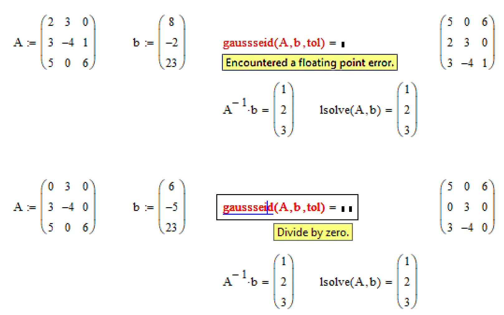

The problem in two examples where I showed that your routine fails has nothing to do with the number of iterations or the tolerance. The same seems to apply for FM's example.
The limit 999 is something you introduced. You could make it a higher number if you want but i doubt that this would much sense.

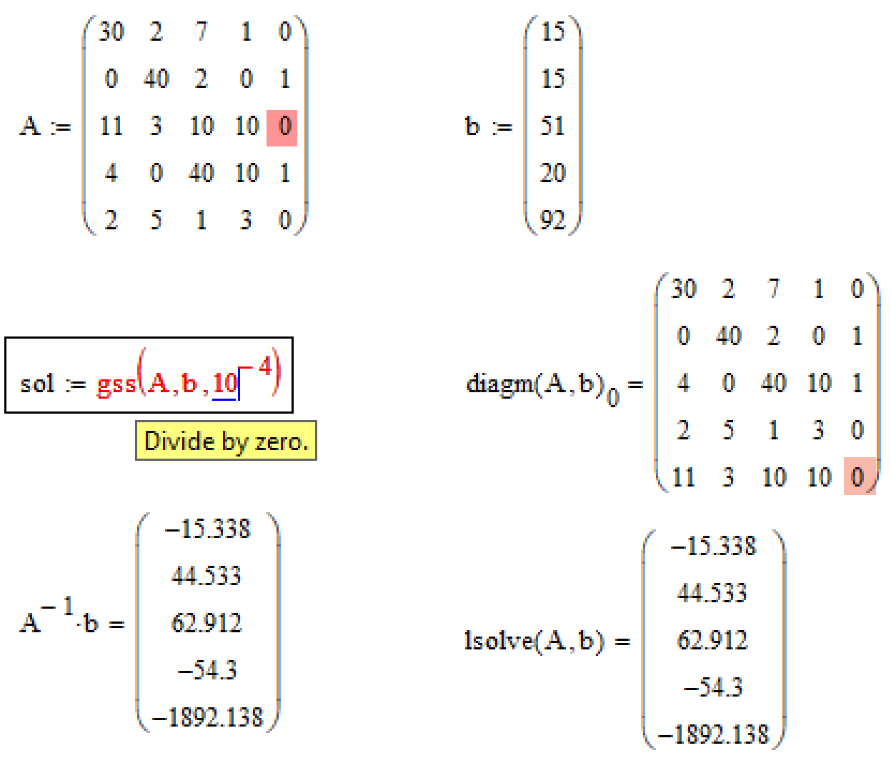

But first you should repair the first part of your program. The matrix created must not have a 0 in its diagonal.

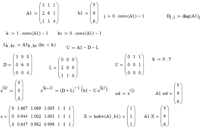

I have done so:

It sure doesn't make much sense trying to debug a picture 😉
From what I see in your first post it looks like we have those big numbers right after the first iteration step?
Have you tried using a different start vector for x. As the program is written, no start guess is provided and so its (0,0,0).
Otherwise you will have a good time trying to debug the algorithm and its implementation to find out what the cause for the problem is.

It should not matter how we chose the components of A. In fact, Gauss-Seidel has its own limitations, that's why appeared also other methods like Gauss-Seidel with Over-Relaxation, etc.

In fact it matters a lot what the values in the matrix A are and how they are arrange. As I have just written, both Jacobi and Gauß-Seidel are very happy with very big diagonal elements. It can be proven that they converge for sure if the matrix is diagonally dominant. If this is not the case, the algorithms may converge anyway, but there is no guarantee. The smaller the diagonal elements are the bigger the chance that the algorithms will not converge which can be seen in the two examples above where Mathcad throws the floating_point error (the values calculated possibly  exceed the IEEE limit of approx. 10^307.
The part of your program which you copied from that pdf tries to cope with that problem by rearranging the rows. This may help in some case but in some other cases it does even worse. In the second example I posted the rows are rearranged in such a manner that the third diagonal element is zero. Of course this will throw the division by zero error. If the program would not have rearranged the matrix elements we would have got a solution.
In other examples the opposite might be the case and its a good thing to rearrange. A clever written program would "see" when to rearrange and how, will make the best from the given matrix A and only the would feed it to Jacobi or GS. Coping with all or most possible cases is a difficult programming task - thats the reason why also in other programming languages math libraries can be bought extra for good money. If the implementation of these libraries is professionally done, thats well spent money.

Better make your program more robust!! The remarks I made above concerning the wrong manipulation of the matrix A in the first part of your program still applies. See the screen shot below. Its from your latest file.
At the right I copied the matrix your program created right before going into the iteration section.
Not sure whats the problem in the first example - maybe simply not enough robust. In the second example its clear that a zero in the diagonal must produce that error.

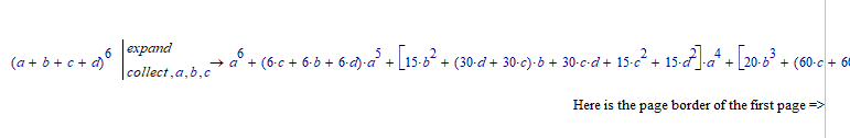

Symbolic calculation is magnificent but is limited. If you want for example to EXPAND the term (a+b+c+d)^6 it will say that is a graphical problem  -  something where you cannot solve through settings. Very bad... I had some work with algebraic equations many years ago....
LucMeekes
(To:tubar)
You mean like this?
No problem. Note that the above shows only the first page or so. The total is 7 pages wide in this 'collect'ed fashion. Uncollected it spans 12 pages.

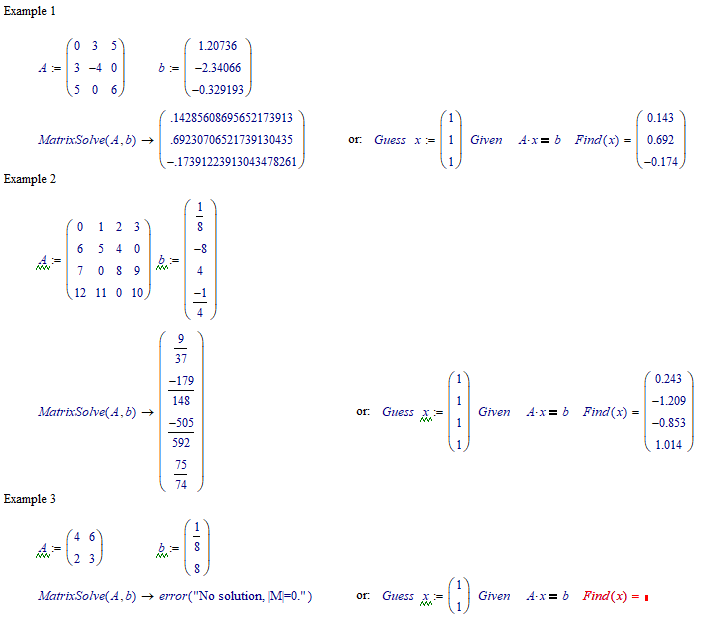

I suppose you're not interested in the simple solution: let Mathcad do the work.
Some usage examples:

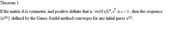

Yes, also restrictive like the criteria of the diagonally dominance.
So, quite often the algorithm will not converge and fail. None of these algorithms will always converge - thats the point.
But by analyzing the given matrix and applying the appropriate of a couple of "tricks", one is able to turn a non-converging set to a converging one. This is what good implemented numerical algorithms will do and the programming work to implement  the special treatment of a number of special cases usually will be much more than the implementation of the pure algorithm. Thats the reason me and others advised against using this self written program for real work but better rely on the tested methods implemented in Mathcad.
Of course there is much literature about convergence of these iteration algorithms and error reduction.

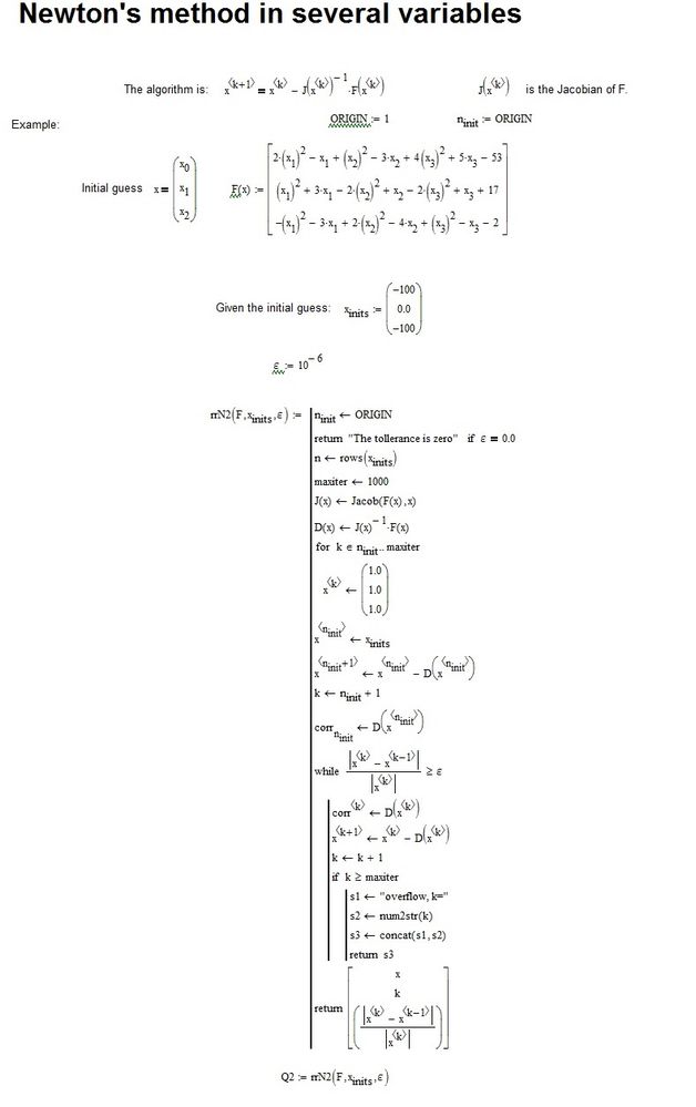

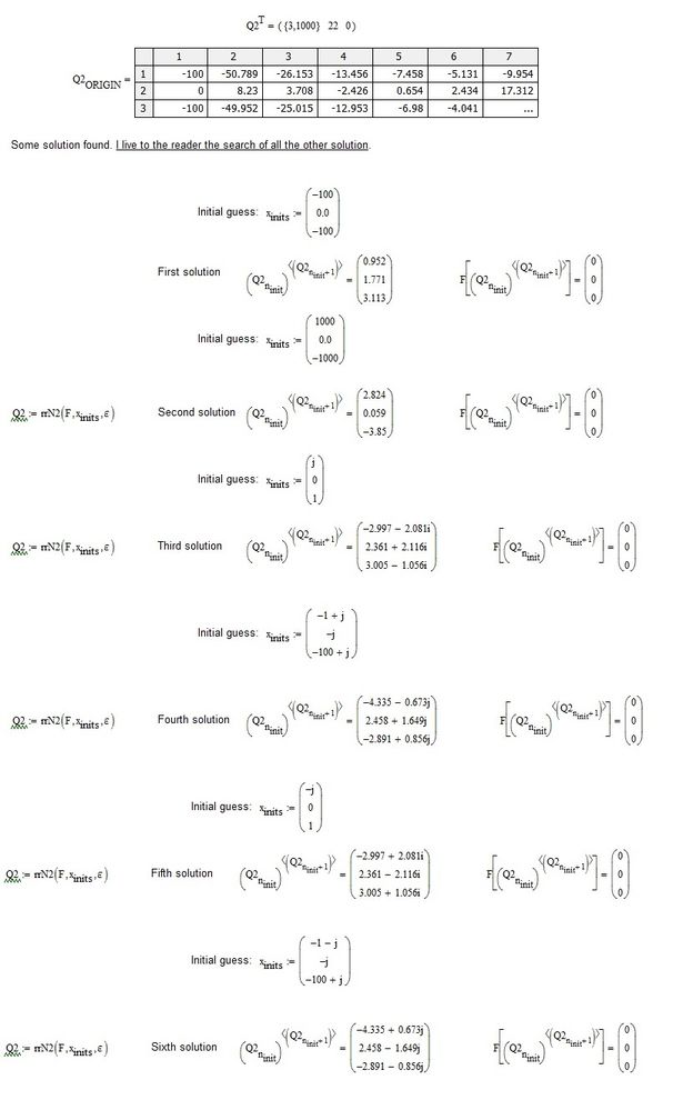

Yes, the most robust algorithm remains the Newton-Raphson method. While it converges slower it is still used further for nonlinear systems of equations.  For the nonlinear systems of equations the Newton -Raphson method is upgraded by the Gauss-Newton of nonlinear systems using least squares.
Nonlinear systems of equations are my challenge for me now. On this area I try some calculations in this moment.
tubar
(To:-MFra-)

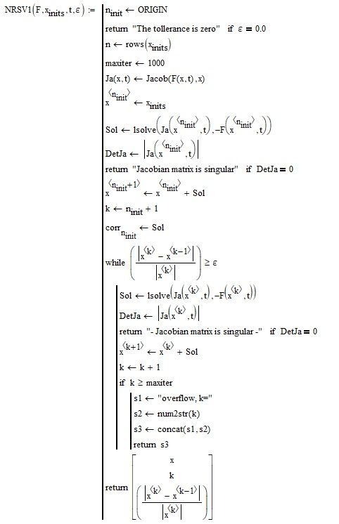

Very nice, but unfortunately you shared only the image.    It is hard for occupied people to re-write the content of an algorithm :).   It is like in primary school.  A completed file would be more helpful.
tubar
(To:-MFra-)
Thank you -MF.   It is quite useful your file. I will try to tweak it further in order to evaluate better the solutions of a nonlinear system of equations.
