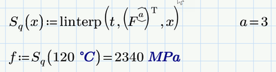

Hi everyone,
I have a problem with interpolating data in Mathcad. Please see the attached file. In Excel, I have defined materials and temperatures. I want to replicate this in Mathcad so that when I select the material and temperature, the corresponding stress value is automatically displayed. Additionally, for temperatures ranging from 100 to 250, if I select a temperature like 120, the stress value should be determined through interpolation based on the material and temperature.
I have also attached my Mathcad file. I approached this in two ways: The first method works for standard temperatures like 100 and 150 but shows an error if I select a temperature like 120 that is not explicitly defined. The second method involves interpolation but only for one material. If I have multiple materials, I have to repeat the process for each one.
If anyone has encountered and solved this issue before, please let me know.
note - these materials and temperatures are not standard and are used only for demonstration purposes.
(To:AK_10948685)
Simply use
in your second method!
The row selector choses row #a in the data matrix corresponding to the material selected via the drop down and the transpose operator turns the row vector into a column vector which is needed for "linterp" to work.
You may also bypass the definition of the variable "m" and use that expression directly in the "linterp" function:

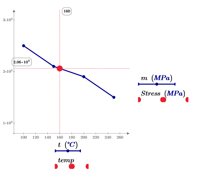

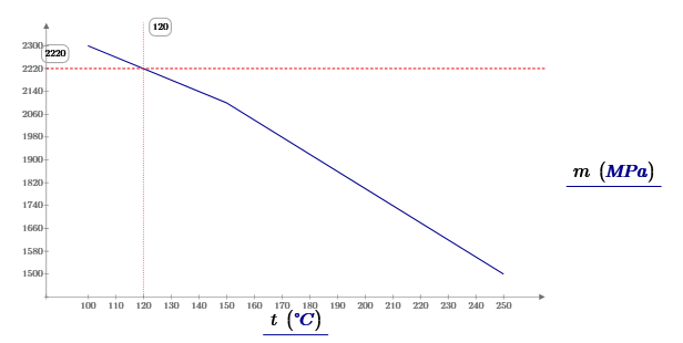

Hi Werner,
Thanks for this solution. I made some changes, according to me. Please see the attached Mathcad file.
Hi ttokoro,
This is a good idea. We can plot a graph. I will use this.
image.png f/ MPa for 2220 MPa line.
