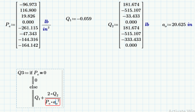

As per this thread - same issue
How to solve the the expression is divided by zero in the above - attachment mathcad prime 8 files

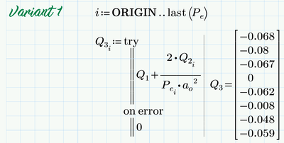

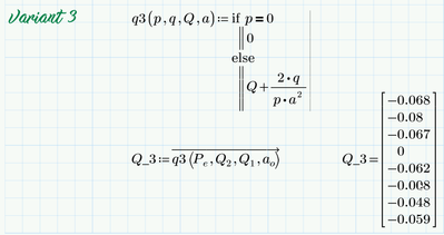

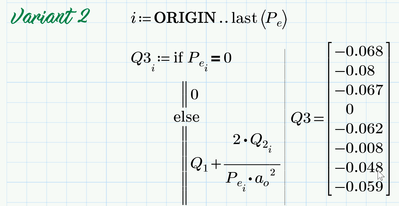

Here are a few variants to chose from:

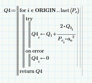

One way is to use a try-error statement in the programming to catch the divide by zero error
Cheers
Terry
