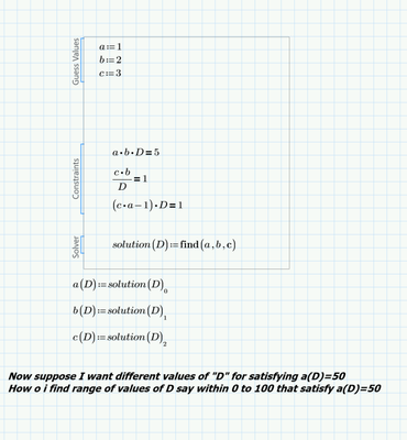

In above case if I want to identity range of variable D in between 0 to 100 that would satisfy a(D)=50. How do I find those range?

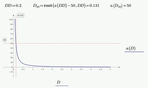

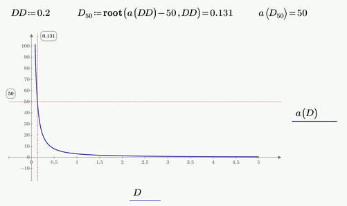

a(D) represents a 2dimensional curve which may have a couple of positions where a(D) is 50, but sure not a range.
In your case it seems that there is only one solution
"root" won't work for a function in more than 1 argument, so you would rather have to use a solve block.
If there are more solutions, you will only get one of them, depending on the guess value.

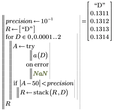

You may find more solutions (if there are any via brute force. But sure this means a long calculation time, if done with three nested loops (for x, y and z), a lower stepwidth than my 0.0001 and a better (lower) precision than the 0.1 in the example:

You have 13 unknowns and 13 equations (hell of a dozen). You specify 10 first guess values, then write down the equations and call the Find function so Solution(x, y, z):= Find(....) . Is it so?
Yes exactly. I want to know that for what range of variable between a limit would one of my equation be satisfied for a known solution.
